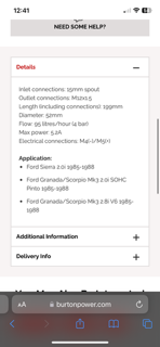

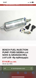

Thank you for the help! I’ve attached screenshots of the pump I’ve found, so you think it’ll be compatible? many thanks for all the help so far!
1 minute ago, IanS said:
Looks as though it is the same pump as you already have but without its anti vibration rubber jacket.
