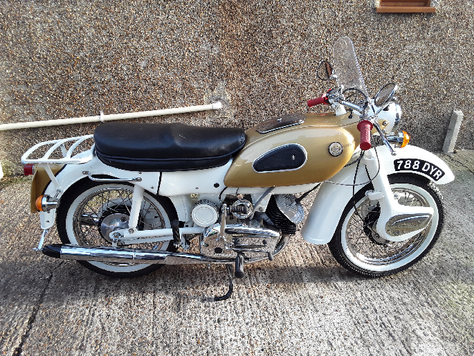

  17. This is more overhead, not a lot of spare room, and not enough for a servo!

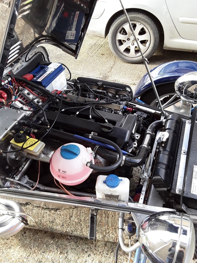

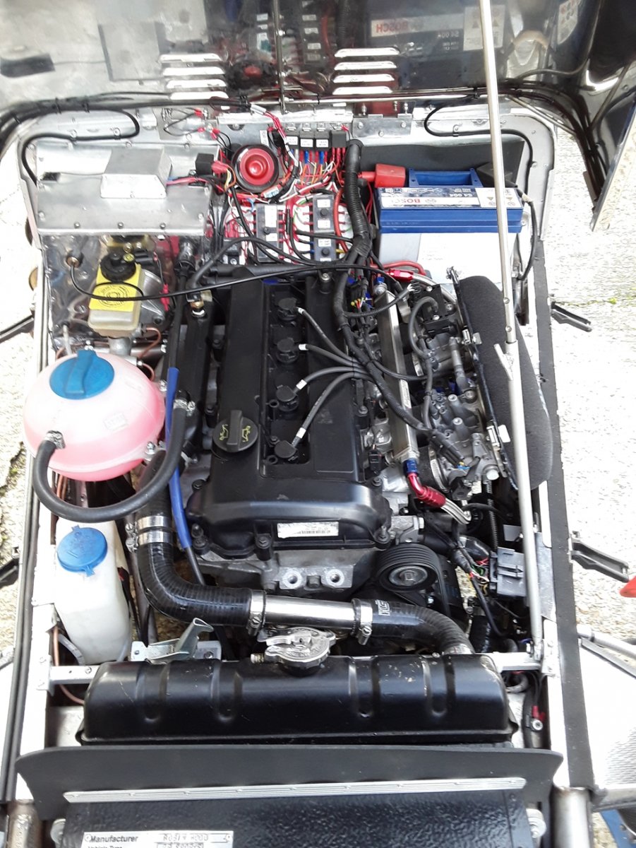

  18. Here is how my 2B is layed out. Engine is a 2 litre duratec from a Fiesta ST150 coupled to the type 9 gearbox. ITBs are suzuki GSXRs on a Danst manifold.
