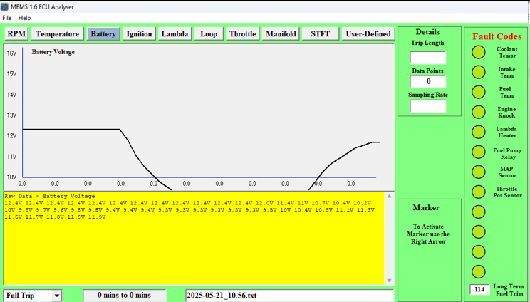

  6. It’s on its way, although I can’t guarantee it’s working, as I haven’t tested it. But it came off a working car so I have no reason to think it’s not working. But we have to remember that what we are seeing on the trace is simply the status of the connection between the ECU and the sensor, not the actual signal it is sending. But it does no harm to try it.

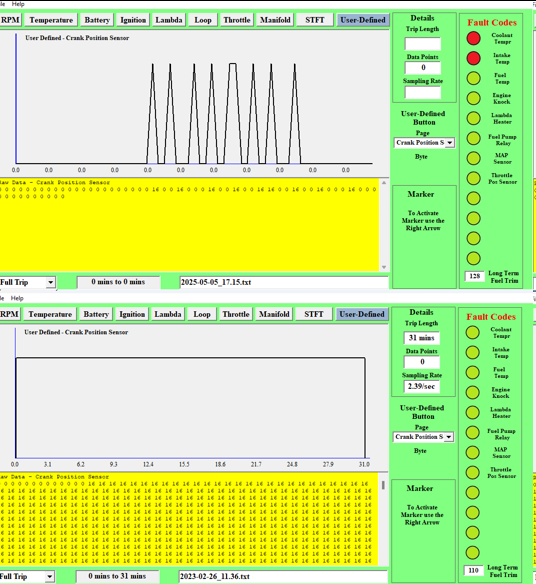

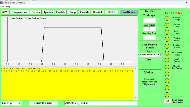

  7. OK, I ran the test on my car. The good news is that my battery behaved exactly the same as yours so we can probably ignore that. The bad nes is that I was right about your CPS. As you can see from my trace it swiched firmly to 1 when I was cranking and it did not deviate. till I stopped cranking So I think yours is not working properly, maybe a loose connecton ? My offer of a spare one still stands. Al
  8. That certainly looks better, the TPS matches mine now. And although it seems a bit noisy the CPS is going to 1 for some time while you are cranking. I'm afraid I don't know much about thw injector system, mine has always worked so I haven't had to research them. I'll have a read up and see if I can find out how to test them. I'll try starting mine tomorrow with the coil disconnected to see what the CPS should like if the engine doesn;t start. Silly question, but I assume you are getting a healthy spark from the plugs ? Al

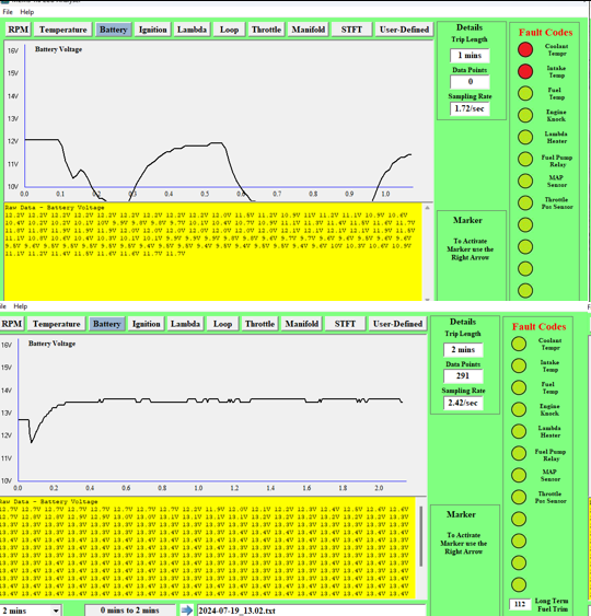

  17. Hi Thomas Thanks for those, most enlightening. There are a few things that I can see immediately 1. It looks like the Coolant Sensor and Intake Sensor are not working (they probably don't show up on your MEMSAnalyser as I only recently updated the display). I suggest you connect MEMSScan and check the Errors Tab, no need to start the engine, and that will show you all the errors. 2. Your battery looks very weak. Before cranking it is only showing 12.2V. A fully charged battery should be at least 12.6V. And it drops alarmingly when crank. We have recently found another Superspec which refused to start as the battery was not delivering enough power. We managed to start it by attaching a battery booster. Here is a comparison between yours and mine, 3. As I suggested before, your Crankshaft Position Sensor looks very dodgy. Yours is very noisy, Again here is a comparison. Admittedly my engine actually starts, but I still think the CPS as shown should be on/off. So worth a look I think. Hope that helps. Al
