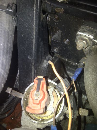

Here's the main culprit that stopped the car from going to the meet-up last week. Faulty wire at back of old distributor: Also a very brittle earth wire trapped under the ignition coil (since replaced both)
