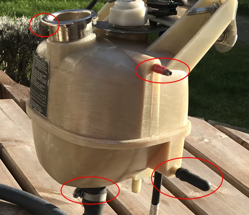

  6. That's interesting. We definitely have 4 connections on the expansion bottle, as marked in this photo.

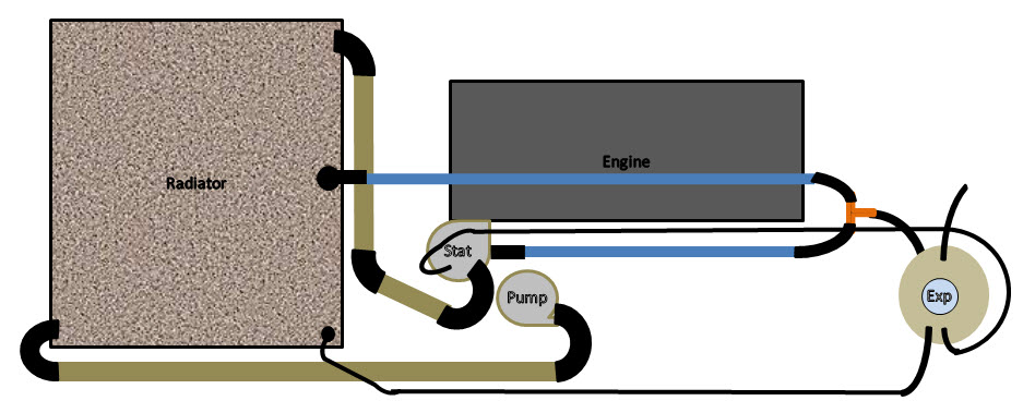

  7. In mine and Al's cars, the cooling system was originally set up by RHE as follows: - large top hose and alloy pipes from thermostat to top right of radiator - large bottom hose and alloy pipes from bottom left radiator back into waterpump - medium hose from closed side of thermostat to the metal water rail above exhaust headers and into a tee piece. On the Rover originally this would have gone to the heater. - hose and metal pipe from the tee piece back across top of engine into top centre of radiator. This would be the 'heater' return. - medium hose out of underneath coolant bottle also joining to tee piece - small bleed hose and pipe from front of thermostat along side of engine, round back of coolant bottle and into top side entry - small bleed hose from top left side of radiator along chassis and into coolant bottle bottom side entry - small hose from coolant bottle cap overflow (mine drops to the road; yours goes to a secondary overflow bottle) So we actually have 4 hoses connected to the coolant bottle. You shouldn't really need the extra overflow bottle as the pressure cap should only release if the engine gets very hot, and over 15-20psi. See my attached diagram. As Al says, we've decided that the design of this is all wrong, in that it feeds the water from the thermostat during warmup via the non-existant heater, back into the top of the radiator. This leads to very long warm up times. I've just redesigned my system as a test. We don't know what car the expansion bottle is from, and I don't think anyone has the float level sensor wired up to anything. There are moulded plastic level markers inside the bottle (you can see when it is empty), but I generally 3/4 fill the bottle and leave a couple of inches air gap at the top to allow for expansion. Your diagram doesn't quite seem to match the setup of our Superspec cooling systems. You seem to have a T piece in the bottom hose from radiator to the water pump, where the medium hose from the thermostat feeds in. This is actually very similar to how I've replumbed mine, effectively taking the 'heater' return water and putting it back into the engine instead of the radiator. So yes, your system looks along the right lines. How quickly does it warm up? And yes you can undo that little bolt on the metal pipe going across engine to let air out when you fill it. I don't have one so always had undo the top hose to fill the system. Andy

  23. Just to update this post from last year, I modified the cooling system on my Superspec over the winter and it seems hugely improved. I removed the pipe over the top of the engine that returns the heater feed back into the top of the radiator, and blanked off the top centre radiator spigot. We've never believed this was correctly plumbed by RH as it means the water pump only draws water from the bottom of the radiator so all the water in the radiator has to warm up, making the thermostat effectively redundant. I then removed the U hose that takes the radiator bottom hose into the water pump, and replaced it with two 90 deg elbows with an alloy tee joining them. Some 17mm heater hose was then used to join the end of the metal pipe from the heater feed (I don't actually have a heater fitted), back into the alloy tee. So there's now a warm-up loop and a main radiator loop. When the engine is cold the water comes out the top closed thermostat pipe around the 'heater' hose and back into the water pump. When it's hot and the thermostat opens, the water gets diverted into the top hose and through the radiator as it should do. The net result of all this is that the engine now warms up to 83deg C working temperature in about 5 mins before the thermostat starts to open, rather than the 12 to 20 mins it used to take. Good result!
