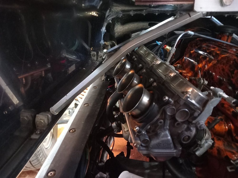

  3. Good suggestion might work, thanks. The support currently sits between two of the carburettor inlets and is bent outwards to clear the carbs well with no filters. I have bought 4 filters, similar to the left hand one in the image, and they are not far off fitting - three fit perfectly. The Ramair foam might well work but I think would deform against the support, but would probably allow the bonnet to close, but I suspect would eventually dislodge as the bonnet is opened and closed. I see that they do flat foam filters in pairs and they may work without adjusting the bonnet support, I am just not sure about forking out another £70 odd, to find that don't quite do the job and, to be fair the others look better! What I should do I suppose is take that support off and see how much extension is available, maybe it will bend out more. It would be nice though to get another one, in case, and also to bend while the other one is no to make measurement simpler.

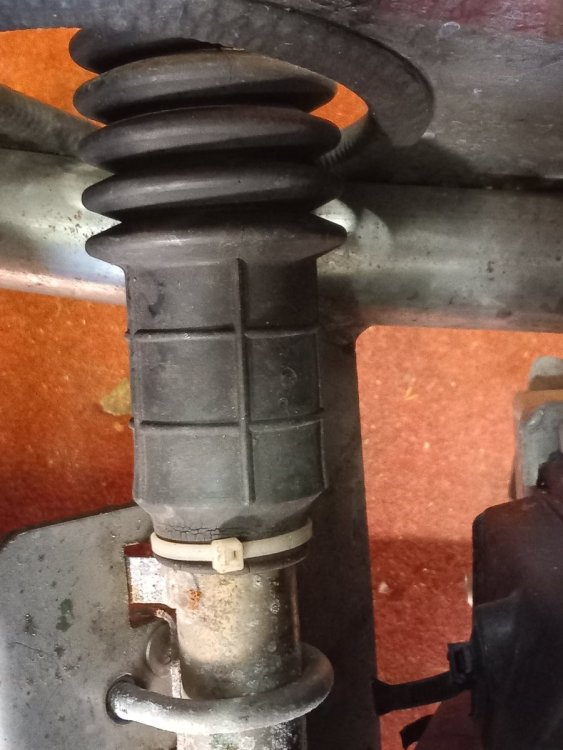

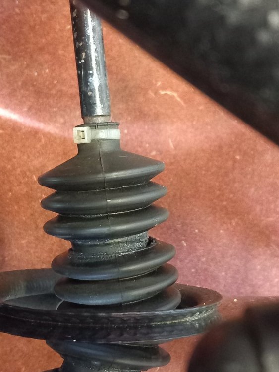

  4. A couple of questions relating to a Sierra based 2B Plus: I have no air filters and want to fit some, so I need to adjust this bonnet stay to move it away from the carbs, where can I get a longer, bendable and adjustable version of this bonnet support? Also I need to replace the o/s steering gaiter so I want to buy a pair. I assume it is a Sierra steering rack, but gaiters I see online don't look like this n/s one - particularly the inner end (2nd image of the gaiter). Any ideas, or have they just simplified the design of the replacements to make both the same?

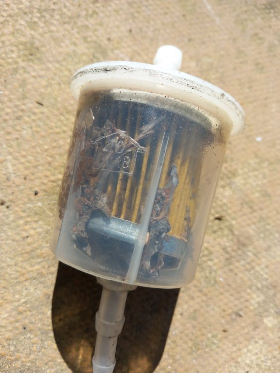

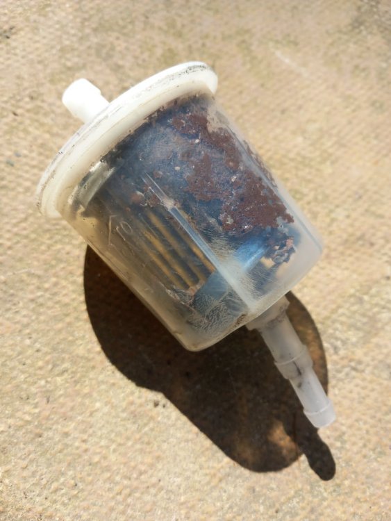

  20. Just to finish this off. My car is started and running well. Although the gunge in the fuel filter would not have helped, the main problem turned out to be the battery - which I had some doubts about! - it no longer had enough oomph to turn the engine enough, to get the mechanical pump to drag the fuel through. I have also fitted a none return valve, but too soon to tell if this made any difference yet. There were other useful benefits of this investigation and fitting seat runners: It made me spot the broken earth from the windscreen washer pump (MOT failure) It made me spot how bad a length rubber fuel pipe was - looked fine but was crumbling away - must check any hidden under the car now. Found a really easy to access and available, ignition controlled live, to power an auxiliary socket - yippee, I thought this would be a nightmare.
  21. Update. This is what I found in the fuel filter - do other people find this an issue? The car was used last year no problem, the fuel was last year's, and it has a stainless steel tank. I have yet to prove that this is the problem causing no fuel to be drawn through, I suppose it must be, but I could blow through the filter and back in to the tank. I'll test it after the replacement filter and non-return valve have arrived, which should have been today. Still a productive day in the sun, with one set of seat runners installed - would have been two if the previous owner had used a jig to drill the holes rather than semi randomly drilling holes in the floor! Also fixed a fault with the windscreen washer spray that I didn't know I had, until I spotted the lose earth wire!
