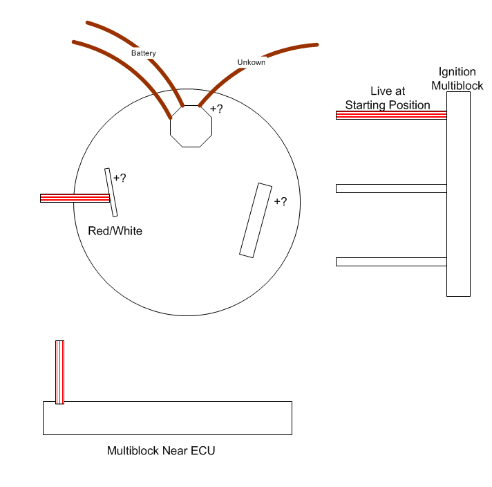

  17. Anyone help in wiring up the super Spec starter. Last night Barry (Bazwaz) and I paid a visit to a chap local to us, who had asked for some help in trying to turn over a Super Spec he is building. After a pleasant chin wag we set about trying to identify why no turn over. Out came the 2 wiring diagrams supplied, which I must say are rubbish. One for super spec and one for Vicki whatsherface, which the loom seemed to be a mixture of. Anyway after a bit of deliberation and judicious use of bits of wire and jump leads we managed a successful cranking of the lump. However Thinks were a bit strange. It seems the small connector on the rear of the solenoid is redundant. The wire from the ignition barrel was feeding this 12v from the starting position but this seemed to be required on the larger spade terminal. The wire that was leading from the larger spade terminal terminated in a multiblock near the ECU that wasn't connected to anything? See diagram below - which I think is correct, but it was late and I have a useless memory. Anyone got any assistance on correctly wiring up the starter for this chap. Cheers Lee
