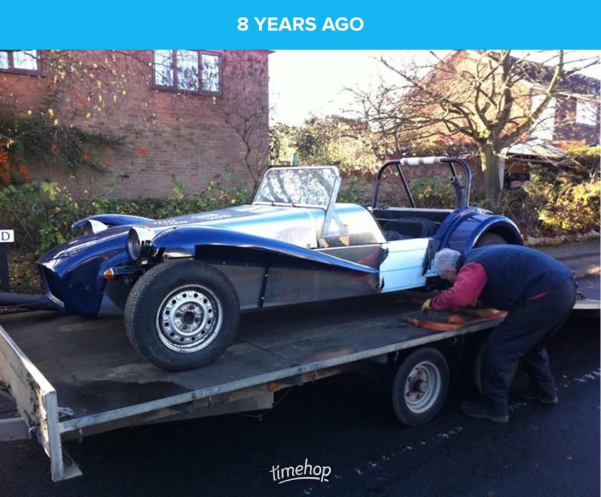

The S7 went through a few iterations with me and I’ll share some photos and details below:
when I picked it up from you:

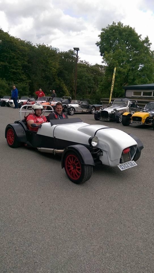

Then in November 2015 it went through the IVA and registration with a 1.6 pinto and 4 speed box and looked like this:
Then it almost immediately came back off the road for winter and had a 2.0 pinto and 5 speed fitted, but in the process of doing so decided that wasn’t going to be enough and so using a pinto efi setup from a late model Sierra I converted to efi and turbo charged it it made a round 150-160bhp at this stage.

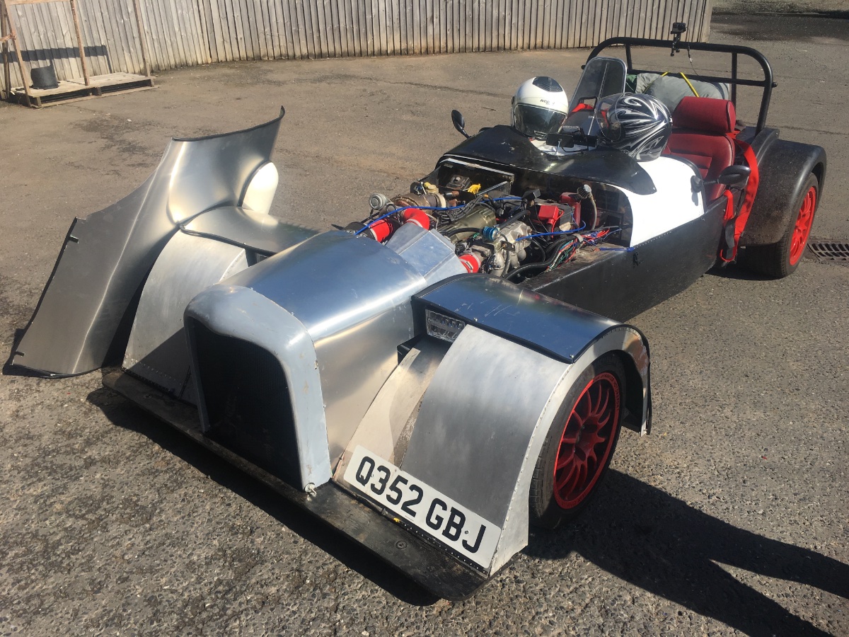

Because of this extra engine work and the fact I was building a custom body and making over improvements to the chassis. The rebuild over ran, but it was (just about) back on the road for the annual pilgrimage to wales looking like this
At this point (august 2019) we had really found, and past, the limits of what the chassis was really capable of handling. Also with that much power in that car, I was suddenly very conscious of how vulnerable you were when driving it. The plan at this point was to do some more improvements to it over winter, fit a quicker steering rack, bigger brakes, finish the body etc.
