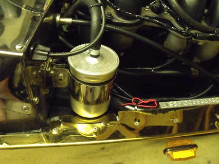

There is this bloody big huge fuel filter in the line - see photo attached and was wondering if ye alls are like that.

I've got the same large fuel filter - but it sits in the horizontal position. Which direction does the fuel flow from the bottom of the filter - to the engine or back to the tank?

One thing to check is that the filter /fuel supply are connected correctly. There should be an arrow on the fuel filter indicating direction of flow to the engine. The fuel should enter the fuel rail at the bulk head end near to the throttle body.

My fuel filter installed just like your picture (in at bottom, out at top) - no problems. All my car is bog-standard super-spec. Have to prime it twice if it's been standing for two weeks or more, otherwise starts after first prime. IIRC, the primed fuel pressure is at 2-bar (think that was from the Haynes rover manual) - I could be wrong. I wonder how difficult it would be to attach a pressure gauge to the fuel system - that would tell you where your problem is.
