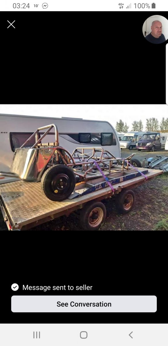

Yes I've noticed a donor car is not going to be cheap. I've found this chassis and not sure what yo do.
Edited by Jon
Wrong one
