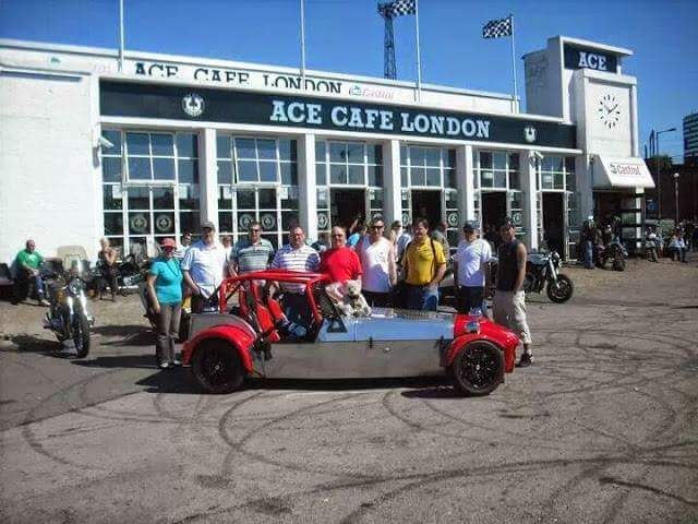

The Ace cafe brings back happy memories of a totally mis-spent youth....
If they were happy, then it wasn't mis-spent :-)
