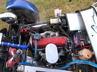

Finally got a picture to show you what type of cooling system it has
Looks like top of rad is highest point so raise front of car then bleed from top hose at rad it's a pain but doable
My rad has a bleed pipe welded in by the manufacture which goes back to the header tank. I've also fitted a bleed tee at the rear of the cooling system (the heater end), (heater? Wimp!). I have no problems bleeding the system.
