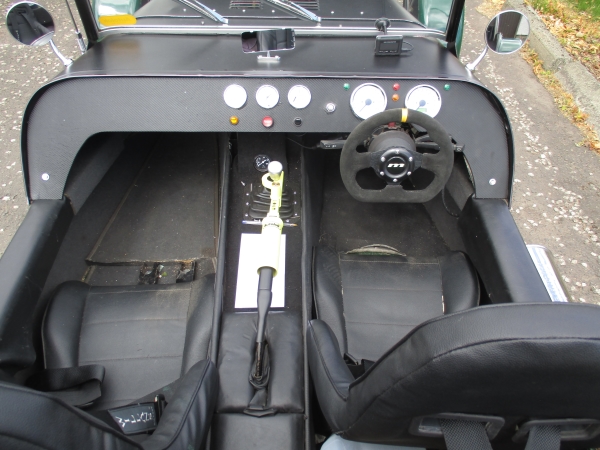

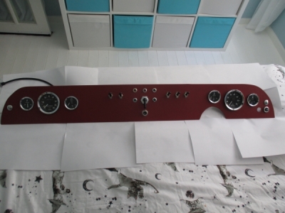

Designed the dash myself, incorporating Lucas Style Toggle switches Name tags, Hexagonal warning lights, New Smiths gauges.
Pics to follow.......

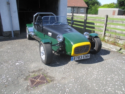

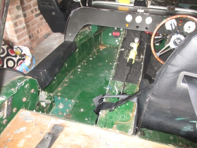

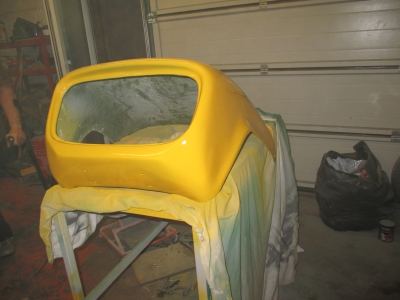

Wooden floor, Nosecone is finished. (Lotus Yellow)

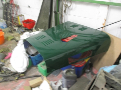

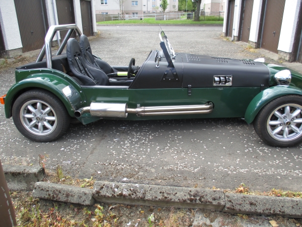

Bonnet almost finished, side louvre air vents to be attached and leaving curved hole on top open which will be finished with nice trim edging. ( Lotus BRG)

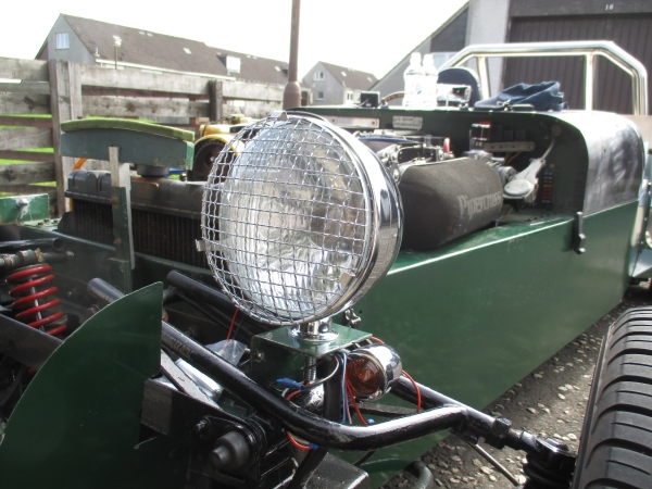

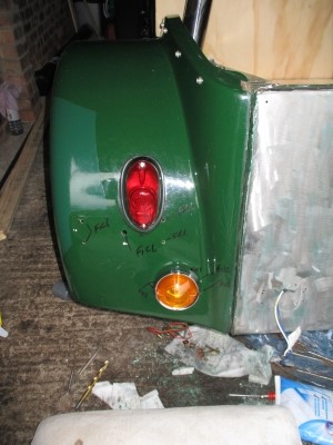

Have fitted all Lucas lights.
Have Bullet type for Cam shell wings.

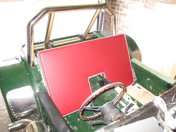

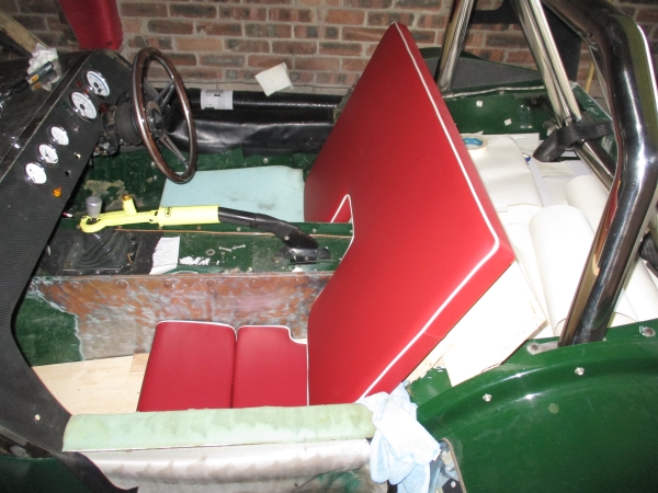

Also had made original style Seats as per S2. These were made and supplied from Mick at xtraspecialsevens.co.uk
Mick has done an amazing job, he's very helpful and is simply the best around!
Extremely pleased! :clapping:
Now I am just fitting them to my requirements, which is a long process as I want them just right!

Great build & attention to detail --- but keep the old seats for use on long trips. We have a 1963 Lotus 7 near us & the owner will always use his Lotus Elan if travelling more than a few miles, 2 inches of flat foam makes the bum numb very quickly.

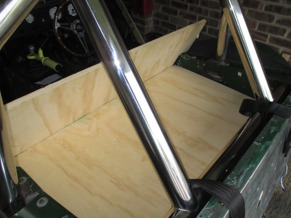

Tomorrow I start to fit the boot floor and then the rear seat board.

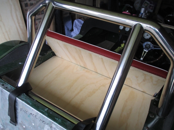

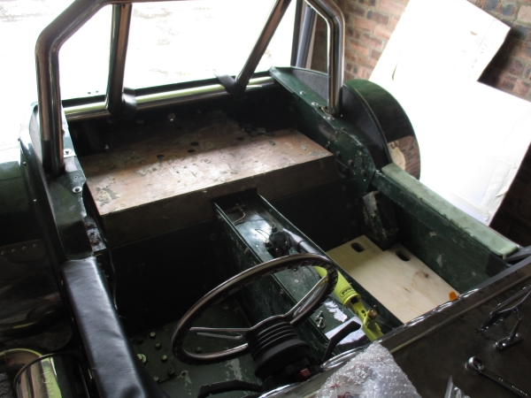

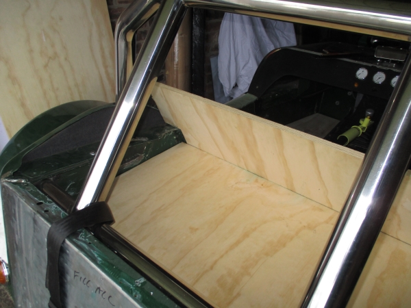

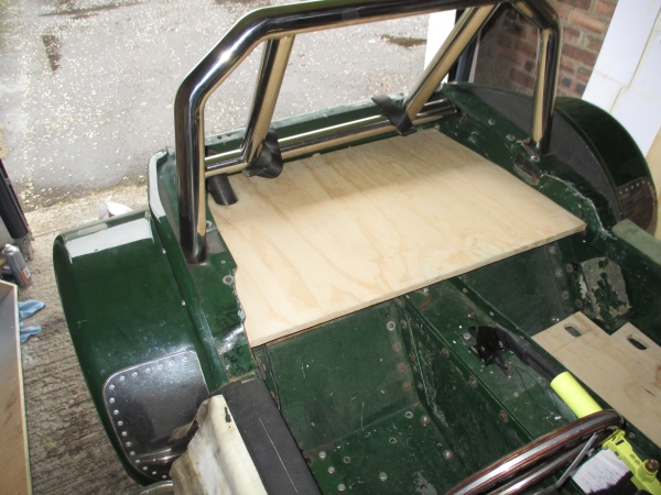

Been fitting the boot floor today, which I admit was painstakingly a long job!!! :80:
But after much cutting and measuring fits like a glove. It's been fitted so it can be removed for access too.

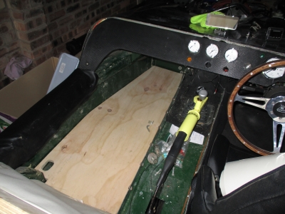

Working on the rear back board, wood for driver side floor, grill for newly painted nose cone, tomorrow.
All going well and to plan.
