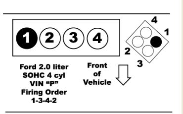

Now we all know the old pinto is a 1342 firing order based upon 1 at TDC & the lead on the connection next to rotar arm direction (groove marker)
However, looking at the wiring diagram in the Sierra Haynes manual (starting, charging & ignition, models up to 1987 except fuel injection) shows the following connections on distributor cap, looking from nearside (cylinders 1234 facing fan)
Plug 1 - to 4 o'clock (ish)
In a clockwise direction, followed by:
plug 4
plug 3
plug 2
Doesn't tie in with 1342 order?
Then the following diagram reveals something different again for the SOHC model
Is it a case of get 1 in the right spot & place the remaining leads where you fancy, on the basis it will only fire in 1342 order??
More confused by the day :help:
