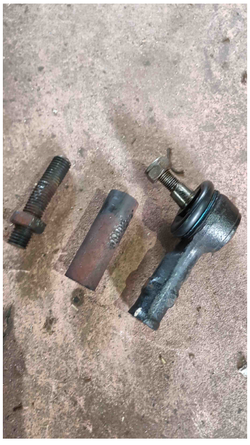

Anyone know if you can buy the extenders between the rack and track rod. My n/s one the thread to the track rod has bent..I can either try and bend it back or get another

Managed to heat and remove the large threaded side that goes into the ball joint. Just need to know the size and get a new piece of threaded bar or change the ball joint to a long Male threaded end instead of a female like it is now..

Do you mean you have a bent tie rod/track rod. Probably best to replace it and you get the bonus of a new inner ball joint and they are not expensive.

Change picture.

if it is sierra, like longboarders picture and it needs extending, then look at granada.... the rods are a bit longer

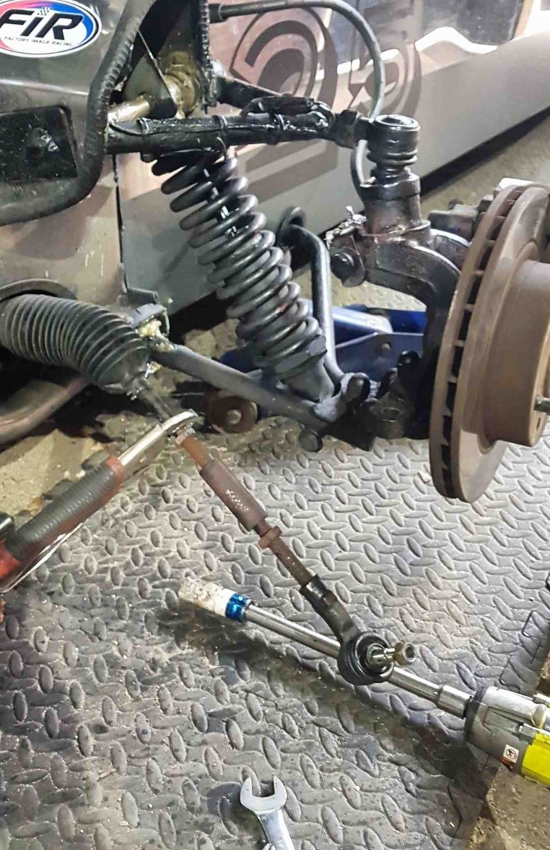

Ive put them back in place so you can see them as they would in place....albiet longer as i havent fully screwed them back in

The cars a 3a New so there are noticable differneces in the suspension setup to that of a 3a i.e. stearing rack is higher as it sits on a stainless steel box section.
