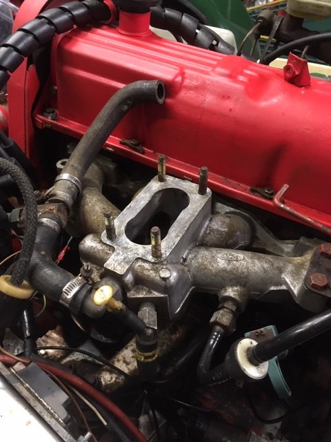

What length manifold do you have? I have seen this setup with a filter on before a while back so it must be possible. Have you got any images?

There is a picture of the manifold attached, and also the plate that seperates it from the manifold.

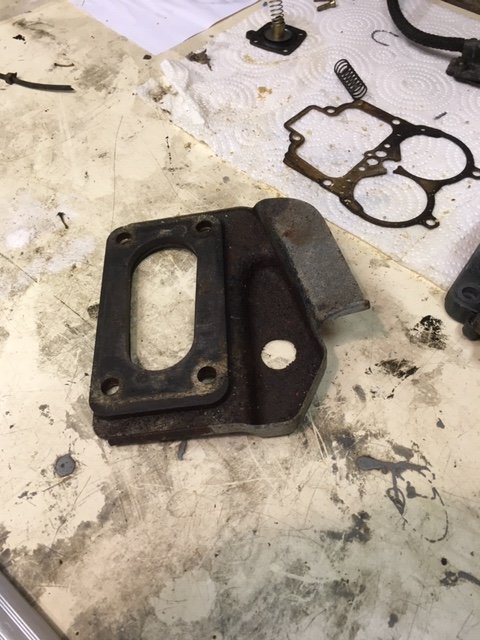

10 hours ago, Peter Bell said:
You may have an insulated spacer between the carb and manifold, try taking it out, will give you another 10mm?
I have attached a pic of the spacer.  Is it there for a reason? I mean insulating or keeping the carb cooler
It prevents heat soak from the manifold to the carb. Without it you might get hot start issues because the fuel in the carb can evaporate. If you've not got a mechanical pump, you'll probably be OK because the engine doesn't need to be cranked repeatedly to fill the carb.

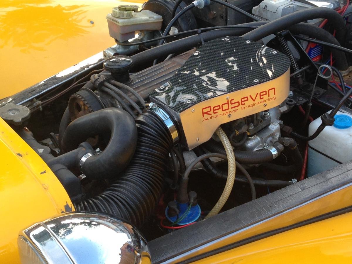

On ‎8‎/‎22‎/‎2019 at 11:58 AM, theduck said:
wow that red seven filter looks amazing,,, where is this from?
