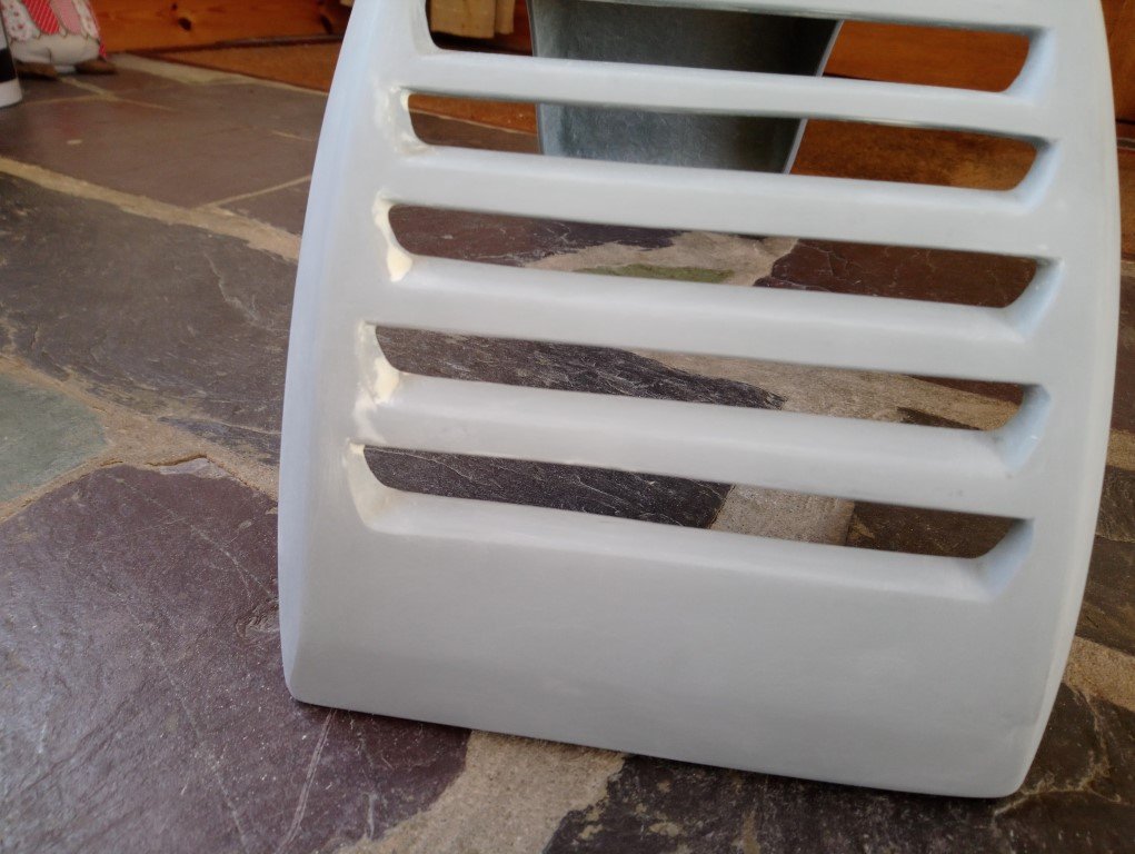

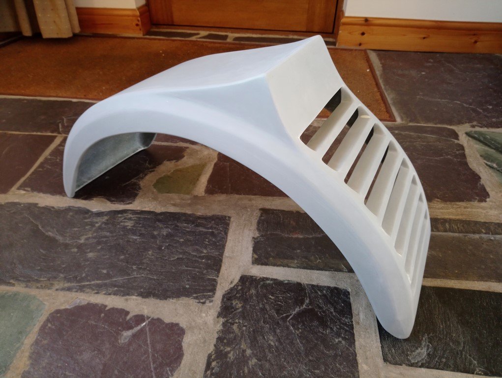

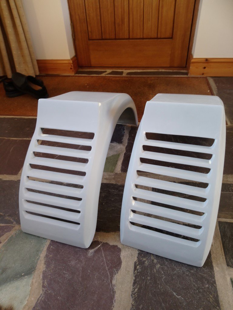

Knowing I get bored easily, @DeanRudkin asked me to trim these front arches for him so I've spent a couple of wet weekends on them, The vents in the back of the arches are molded closed and were trimmed out with a oscillating saw and a Dremmel. The cut edge of the fibreglass was then thinned out to look a bit more even. Finally the arch was given  a good flat over to remove the mold join lines and small skim of filler here and there.
Here's the final job, they just need priming, a wet flat and the top coats and they're done.
