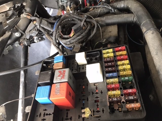

I have looked everywhere where and can’t find a relay.  Is it possible it’s in the fuse box?  I have more relays than my s7 fuse box.
That's the standard Ford fuse/relay box, think the flasher relay is either the red or grey in the middle.
If you can trace the wires from your light stalks then you should find a 3-wire circuit with a triangular 3 pole plug fitted that
should have the flasher unit fitted as behind the dash board.
Hope that helps. Not in the fuse box.
It should come out the loom at about the same point as the brake light switch wiring.

The image is taken from a friends wiring of the doner loom so I would assume that your wiring would be the same.
You can clearly see the flasher unit hanging from the harness in the picture so follow the 3-core wires back to the main loom.

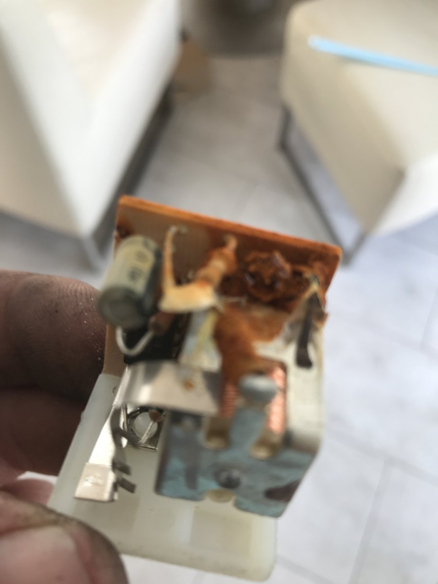

So where was it located before you found it?
Think you have a little bit of water ingress!
