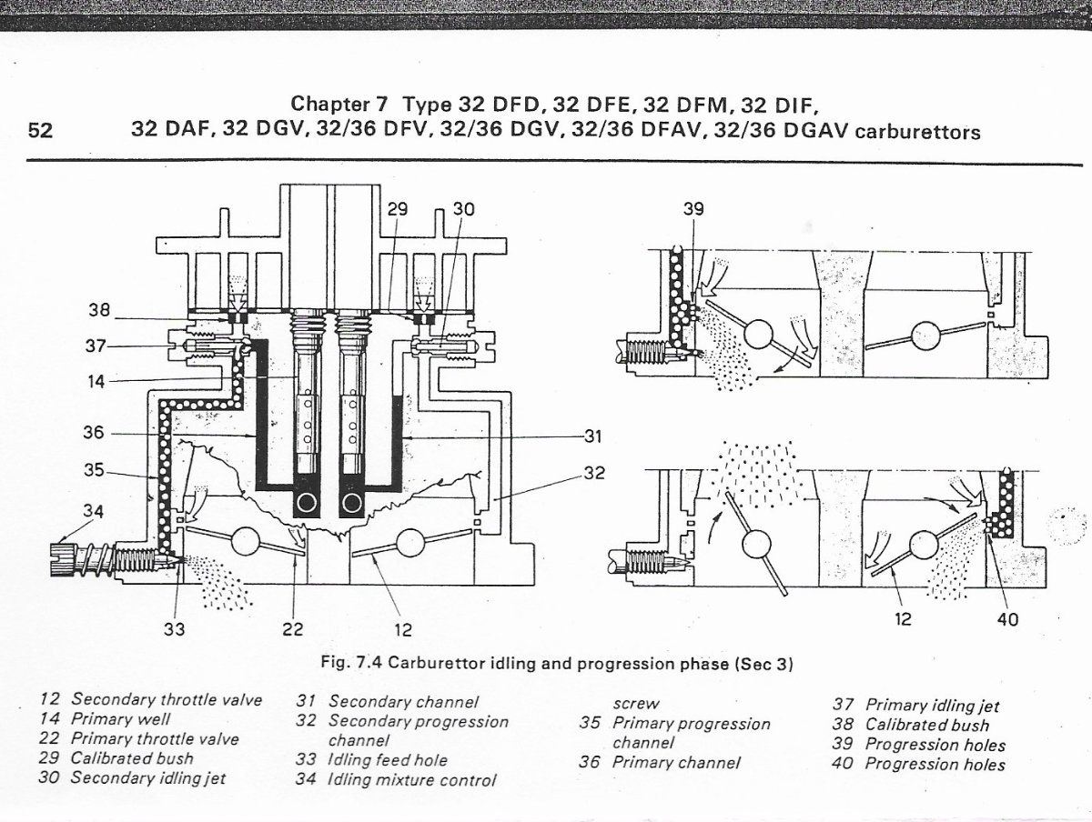

I guess you really need a new thread for this problem but I'm struggling to quite understand what you are saying, here is a picture of the DGAV idle circuit. As you see the fuel drawn up through the idle jet 37 mixed with air and then the amount going in is controlled by the idle screw 33. The Butterfly is only very slightly opened the progression holes are on the 'open' side of the flap. There is a throttle stop screw on the mechanism which opens the throttle slightly to finalise the idle speed. As a rough starting point fully close the idle screw then undo it about 3 turns.

That diagram is quite helpful. Yes, I need to start a new thread I think.
I can explain what I think is happening or not. If I take the carb off, I can see what position the throttle plate is in when the engine idles (badly).
The throttle stop screw you describe has to be turned in so far for the engine to run. When I take the carb of I can see the Idling feed hole (33) is clearly exposed, but I can also see that the progression holes (39) are also open which means to me it's not running on the idle circuit.
If the throttle plate is closed any further to only expose the idling feed hole (33) the engine just dies.
The idling mixture control (34) no longer makes any difference - but that would make sense because I see it is below the progression hole (39) (assuming they use the same channel).
So why wouldn't it idle? Too little fuel or too little air?
If something was blocking the primary progression channel, the progression hold wouldn't work either right?
Does the calibrated bush send air down that channel whilst on idle? Could that be blocked and that why fuel only flows when the throttle place is opened using the air sucked down that way to extract the fuel?
The primary progression channel should (35) have a petrol/air mixture in itwhen the throttle butterfly is nearly closed.
This is sucked through by the vaccume under the butterfly.
The diagram shows this as white air bubbles in black petrol.
So yes check the calibrated bush.
