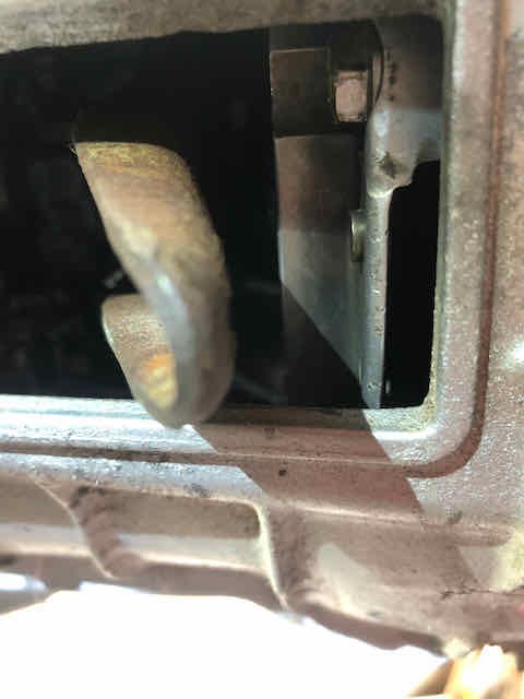

My issue today is when mating gearbox to engine with new release bearing from GBS I literally have about an inch of meaningful travel on the clutch release fork. My flywheel is a light weight turbosport item, the clutch plate is a cg 5 paddle and the pressure plate is from a focus rs turbo.
Any help would be gratefully received in working out why I have so little travel between thrust bearing engaging with pressure plate and full travel of the fork.

I spoke to GBS this morning and they assure me that I need their TRA0019 part which puts the clutch fork in the correct position. As it happens, I had bought one of these in anticipation of this very moment some time ago. The gearbox I had purchased had the original work around this issue, drilled and tapped and a M12 bolt with a filed end to fit the fork. This is adjustable as well but still gave this issue whereas the fork once engaged with bearing and pressure plate leaves around 1cm of travel for the clutch which is not nearly enough. I have an image of the fork at engagement of thrust bearing to pressure plate. As you can see it literally has around 1cm of travel before the fork runs out of space. Just to be clear, the bearing is a GBS part as is the fork pin.
Any help with this would be gratefully received.
Craig

Where did the gearbox come from?
There are a couple of various although rare types of this box which had a setup called a low lift clutch this was something tried by Ford but was soon dropped as customers were complaining of crunching when changing gears.
The gearbox originally came from GBS with remote gear shift and adjustable clutch fork but was never fitted - I purchased it from another zero owner. That said, I did chat with GBS today and discussed the issue which they say seems ok but the only way to find our for sure is to fit the engine and try it.

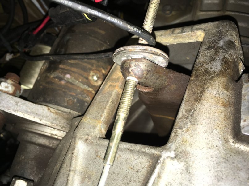

I know this won't really help, but as I had my Superspec on axle stands I took the opportunity to take a picture of the clutch arm on my MT75.   As you can see there is nothing like the obstruction you have and mine has full travel available (no idea what the audio cable is wrapped around the cable, I will have to investigate 😀)
I can only assume that your clutch pressure plate is a lot wider than the one fitted to the Superspec (Rover T16 engine).  I can't help you on what model clutch I have as Superspecs seem to odd.   We had assumed Rover, but some have reported Ford and one owner who is presently stripping his down says the clutch has a Mazda part number.  I should also note that I have a spare gearbox and the clutch arm on that is totally different to the one on my car.
