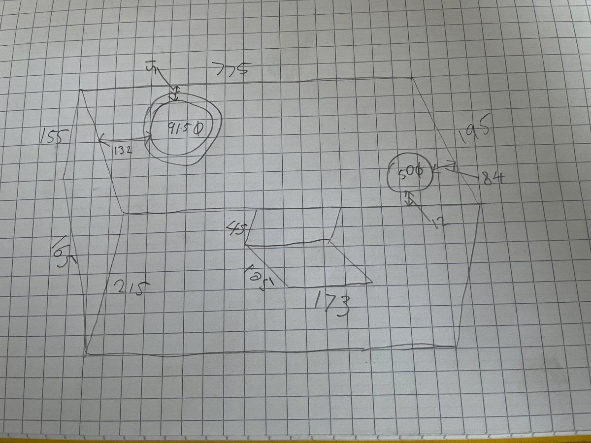

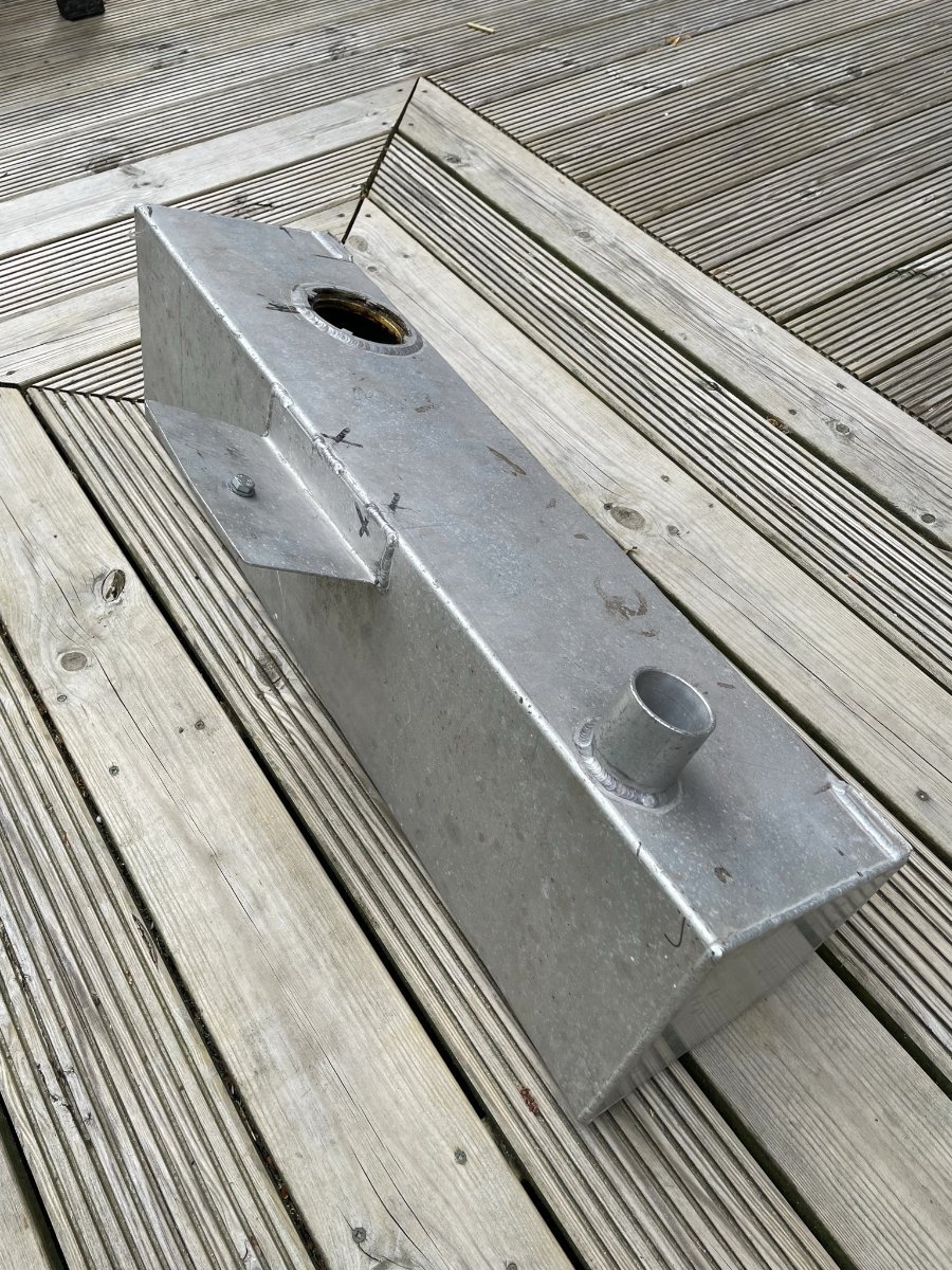

Sorry about my drawing skills hope this makes sense to you. All the dimensions are in mm it is probably easier to compare the picture to the drawing.
Unfortunately this is much smaller than the exmo tank and the holes for filler & sender do not line up. I've just taken the tank out and mine is 860mm wide...rivnut tool has arrived though so I am going to go down this route.
Thank you for going to the efforts of the drawing though, much appreciated.
