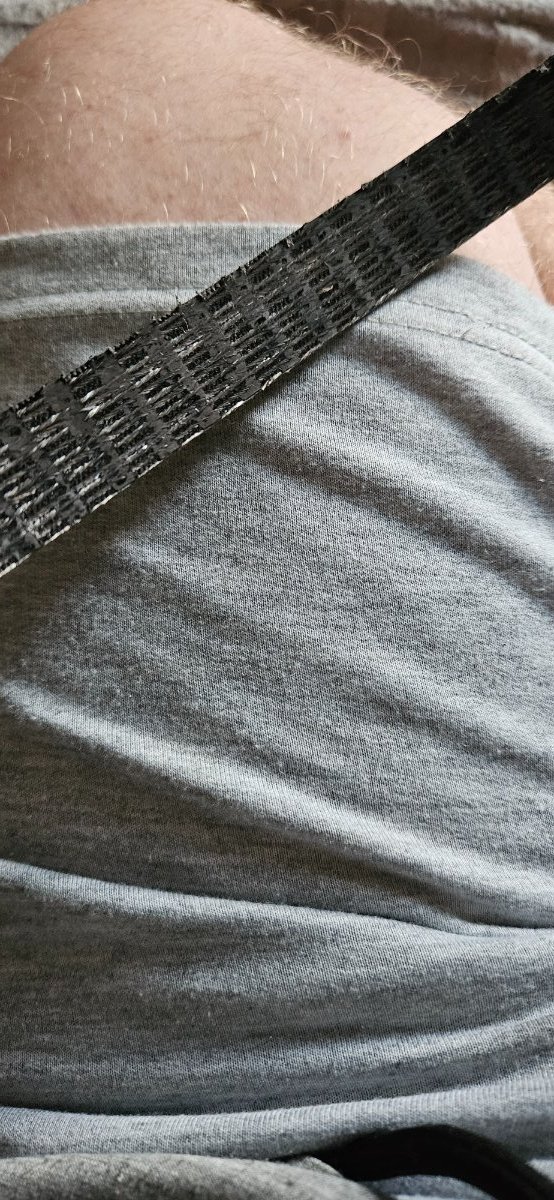

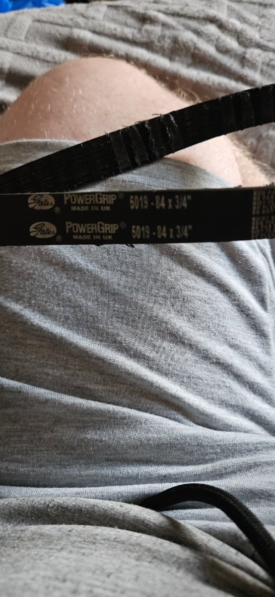

Hi guys, so spent all day rewiring the car, took it for a drive and had a horrendous whirling noise, overheated too, upon inspection the alternator belt is completely shagged, worrying thing is I got a box full of spares and in the box is another belt in exactly the same condition, only problem I'm having is when I type the part number into Google it comes up with a timing belt, I don't suppose anyone has a part number for a alternator belt for a 2.0l pinto, I'm assuming (and I could be wrong) that the alternator belt isn't the same part number as it would be on a normal car? I'll post a pic of belt and of part numberΒ

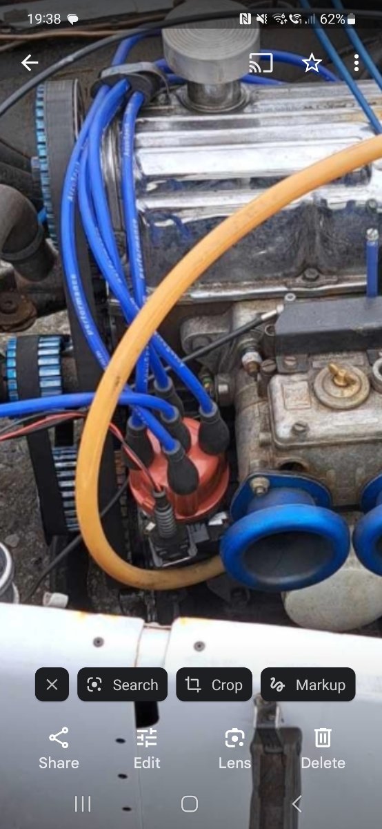

Cheers mate, nothing is normal about this car, all pulleys are blue toothed pulleys, the bottom rad hose runs through the belt so im going to have to drain the coolant to fit a new belt, only had the car 2 days and it's already getting on my nerves, broke down yesterday, now this lolΒ

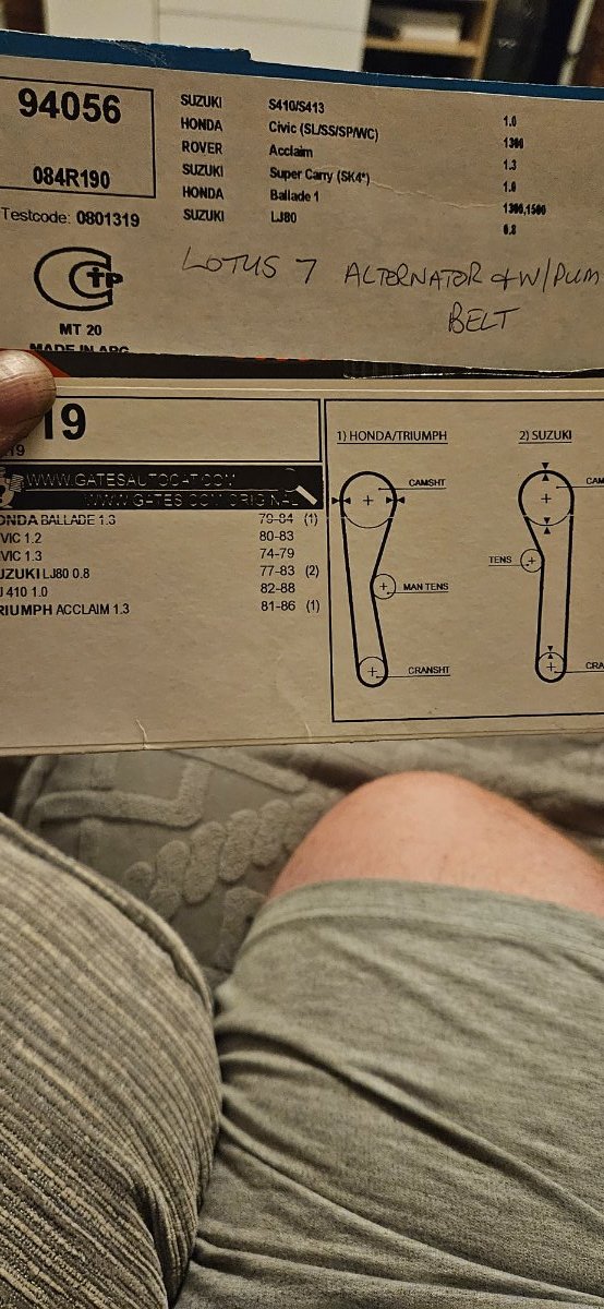

You've got a cambelt used to drive the alternator and water pump. 84 teeth and 3/4" wide like this
https://www.onlinecarparts.co.uk/dayco-223948.html
and used on the Honda engines shown on the box you have. Any decent motor factors should be able to get one.
You don't want the belt too tight or it will fail, you should just be able to twist it 90 degrees in the middle of the longest run between the pulleys.

Thank you very much mate, new belt ordered, if this one straps then I know there's a issue somewhere with the pulleysΒ

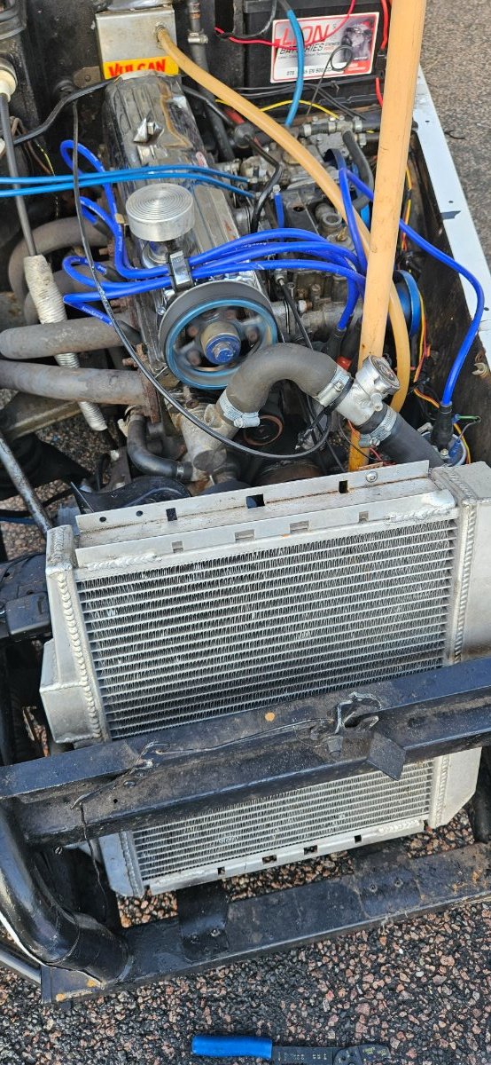

New belt on, pain in the arse to fit, the bottom rad hose runs right through the middle of the belt 🀬🀬🀬 the more I work on this car the more I'm beginning to find wrong, there's got to be an easier way to get the air out the system lol, I mean the rads fitted sideways and I'm a plumber by trade and the top rad hose elbows above the engine and back down again.
I think my first move would be to get the radiator turned the right way round. If it doesn't fit the right way round then one that does would be a good move. They are designed to work with the elements vertically positioned.
To be honest, i flushed it out, put new coolant in, managed to bleed all the air out, left it running for about 20 mins (just wrapped exhaust so need wrap to set) and the temps didnt go above 80Β°, i didnt think the rad would work that way but i did see another person had fitted their rad sideways, cant remember where i saw it though, im gonna have a scout round nowΒ
