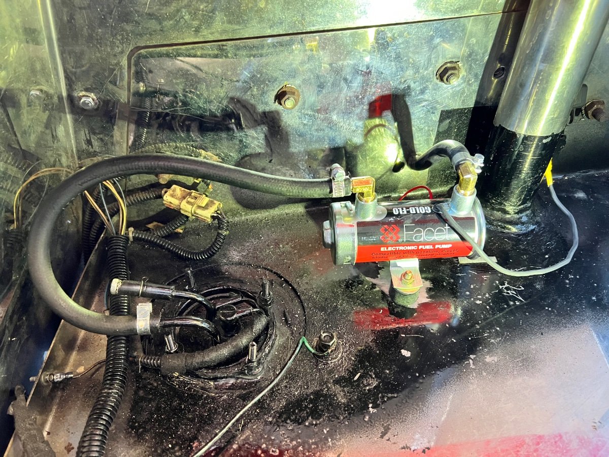

I have just swooped the mechanical pump for a facet electric pump. All wires in pump runs when ignition on but is not getting fuel to the carb ? Any ideas I thought this pump would be easily strong enough? I have took fuel hose off under bonnet before regulator and it is bone dry ? IMG_7232.thumb.jpeg.d0a57be1f289a52860ff1df9ea00e063.jpeg
As I see it there are 4 posibilities.
1 pump fitted wrong way round and is pumping from engine to tank.
2 no petrol in tank.
3 blockage.
4 dead pump.
I am hoping that you have already checked 1 & 2.
If you disconnect the outlet from the pump does fuel flow? If it does blockage in line to engine. Otherwise blockage between tank and pump. Did you use PTFE tape around the right angle connections as this can block the connection. Dirt in the system can also cause blockage by stoping the non return working I do not see any filter in the system.
Fingers crossed that you find the fault.
Ian
Thanks Ian pump is right way round I dipped the tank with a piece of tube about 2 inch of fuel in tank I will go and get 5 gallon to be 100%  fuel line is as was for old pump so should be clear but again will check, no PTFE tape used anywhere. Should be something simple mainly wanted to check pump was suitable and the turns on fuel line where not causing the issue
That pump should do the job no problem but I would really recommend a filter between it and the tank.  As Ian says these pumps really don't like any dirt.
Good luck,  Steve
So I have finally got somewhere ! I took a new power supply straight from battery to pump and it ran way faster and pumped fuel immediately. The power supply I was using was from under the dash coming out of loom so I need to create a new feed to the pump and all should be good 👍

Hi Jim,
Just looking at the reflection of your pump's ground wire in the video - it looks like it's going to the top of the rubber mount, not actually to ground ????
Difficult to tell properly from the video but could this be your problem ?
Edited by Foz
Hi Foz in part you are correct one end is on the top of the bobbin therefore touching the body of the pump the other end sits on bottom of bobbin touching the boot floor that I cleaned with a flap wheel before hand to ensure a good connection. I’m as confident in the earth as I can be
