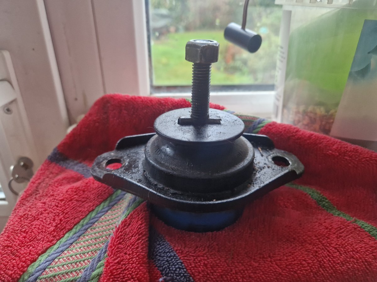

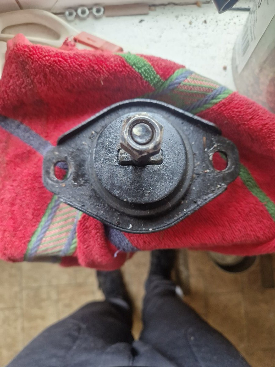

When removing my engine one of the rubber feet pictured that was connected to the engine arms broke. I want to replace the pair but can seem to find the same set online. Anyone know where to source these ?
Many thanks
Rory
Hi thank you for the reply,  they look very similar however the current ones have a small solid bar that slots into the engine arm and non of the new ones have it. Is this something they may have done away with ?
On the Mk1 Sierra (at least mine) the engine support arms do not have a slot. They use a special washer and spacer that fits over the bar in the mount and slots into a hole in the support arm. This means that there is no twist on the bolt in the rubber part when tightened or loosened. I attach two photos below that show the washers and the arm.
