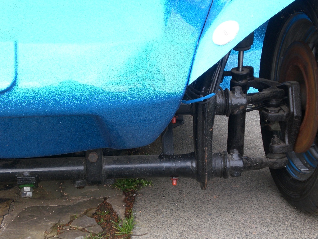

  2. OK, thanks for your replies so far Guys. Right, it seems that it's one of two things. 1. No chassis modifications = IVA not applicable. 2. Chassis modifications = IVA applicable. I cannot answer this question, but I've passed the link for this thread on, so that he can digest & progress with VOSA.

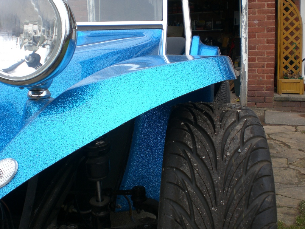

  3. ... 5. OK, last one for now. This edge seems too sharp to me. I think I'll be giving him the link for Woolies. I didn't want to sound alarmist, but as we all know, the SVA was expensive and the IVA is even more so. I'd hate him to get knocked back on such fundamental things. Or, is it that Beach Buggies are subject to a completely different set of regulations? All comments/pearls of wisdom would be much appreciated. TIA

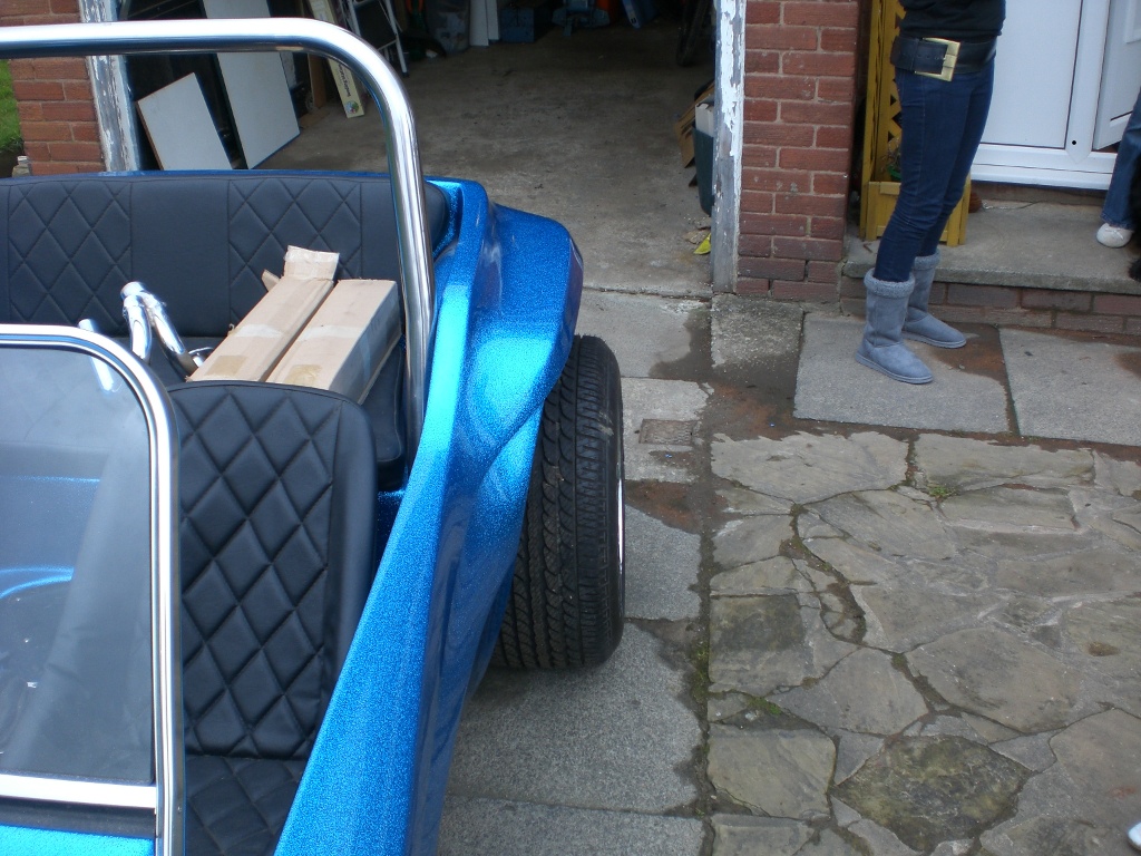

  4. ... 4. Surely, he won't get away with the rear wheels protruding like this?

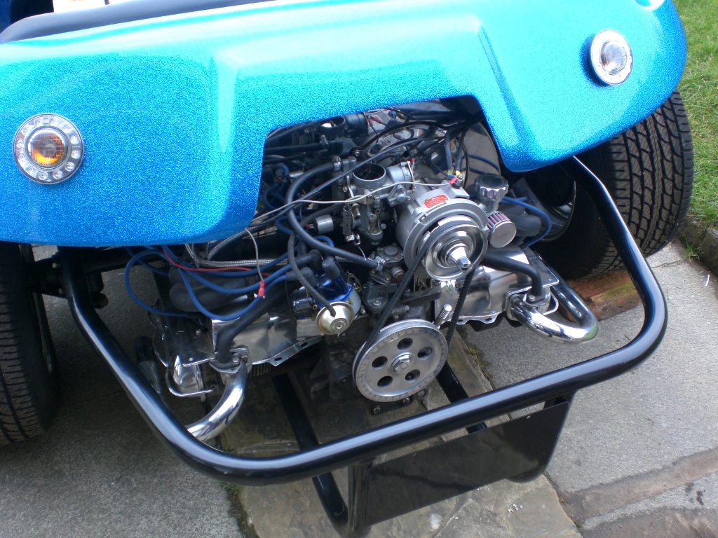

  5. ... 3. There's an Air Filter and a fan belt cover yet to be fitted, but is an exposed engine still OK? He has some cans to go on the exhaust, but is under the impression that Noise levels don't apply - Is this true?

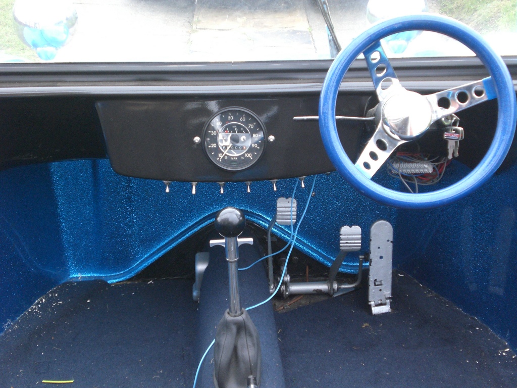

  6. ... 2. This is the dash. Are these switches OK? Will he be needing some edge trim in the steering wheel spokes? There's no Demist for the windscreen? The wipers don't have a Park facility. He say's that 60's Dub's didn't have one? Does he need a Brake Fluid Reservoir Warning Light?

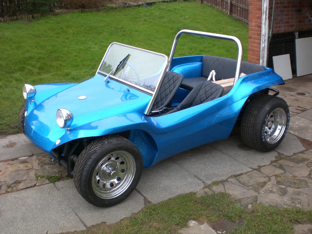

  7. ... I'm a bit concerned for him though with regards to IVA and having absolutely no experience of this particular marque, I thought I'd ask on here. 1. I've pointed out the obvious stuff, like the need to cover pretty much all sharp edges. SVA Nut Covers & Edge trim etc.
  8. Hi Folks, Just been round for a long overdue visit to my daughters boyfriend's house. He has a Manx Beach Buggy kit very near to completion and it's looking really good.
