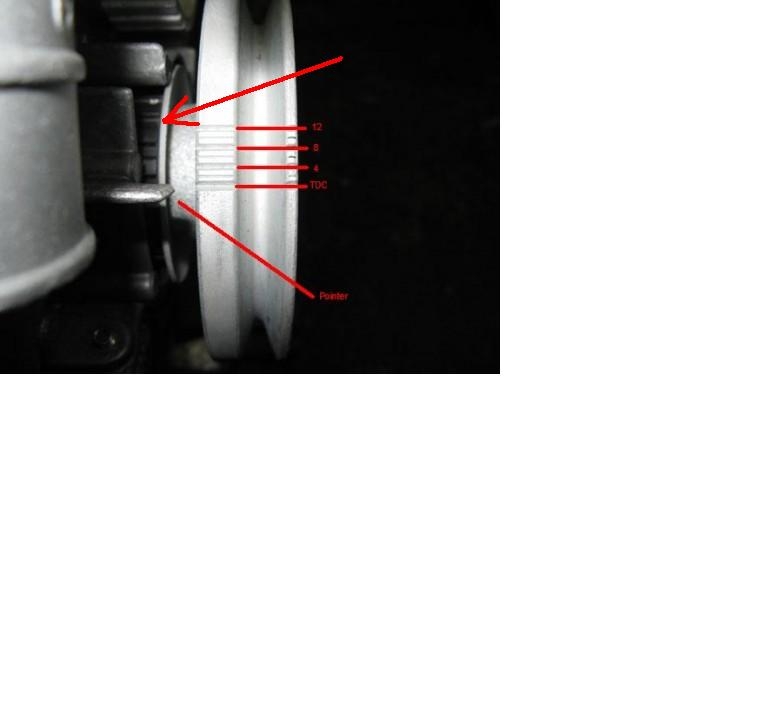

  10. If the washer's there, then the belt should only move fore and aft on the pulleys by maybe 5mm. You're probably ok to check the timing, maybe highlight the marks with tipp-ex to make them stand out a bit more. If you're not completely confident, I can pop round tomorrow night after work and give it the once over. pm also sent.
  11. Here's an actual photo. The arrow points to the washer and you can see it's relative position to the timing pointer. The dished shape of the washer stops the belt wandering forwards.

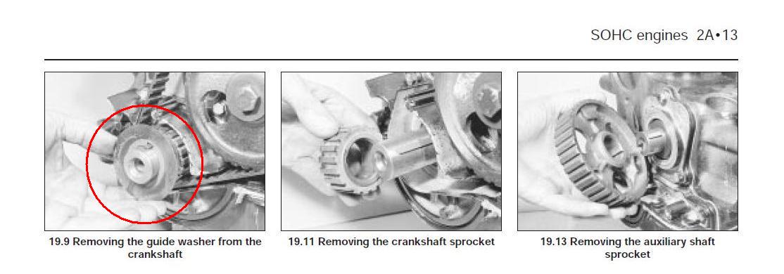

  12. Look underneath the car, immediately behind the crankshaft pulley in front of where the cambelt goes, you should see a big washer as shown in this image. If it's not there, the belt will move around on the pulley.
  13. Apart from all the ignition stuff that's been swapped, have you have the cambelt off of adjusted the tensioner? Interested to see what's happening regarding the cambelt moving around. Also, is the edge of the belt marked where it's rubbing on the cover or is the cover similarly marked. I can possibly get a cam pulley washer today if yours is missing.
  14. Look from underneath, the washer should be easily visible if it's there.
  15. If you can slide the belt back on the pulley then it's probably too loose. Just thinking about my earlier post. The big dished washer that stops the blet moving is fitted IN FRONT of the cambelt sprocket in the crank, between the sprocket and the bottom fanbelt pulley. Thrashed forgot to fit this on his car and the belt was moving forwards on the pulley. Check you've actually got one fitted. Badly worn tensioner could also possibly cause the belt to move about.
