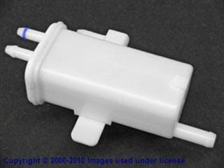

You might find fitting one of these helps. I have some thing similar on my 2b. I used this as my original carb only had an in and no return. Fuel would come from the pump into the bottom and out the bottom of the reservoir to the carb. The return would come out of the top. Now that I have a weber, I have the pump going directly to the carb, then the return from the carb goes into the bottom of this reservoir and the return to tank comes out of the top. It maybe a height thing between the in and out that breaks the cycle. I'm sure some one can find a bottom joke in there somewhere Nige
Hi Andy, Could it be that the return line is causing a syphoning process. Once the engine/pump stops the return continues to drain he carb. Maybe a shut off valve in the return line might stop that, (off the top of my head). Nige
