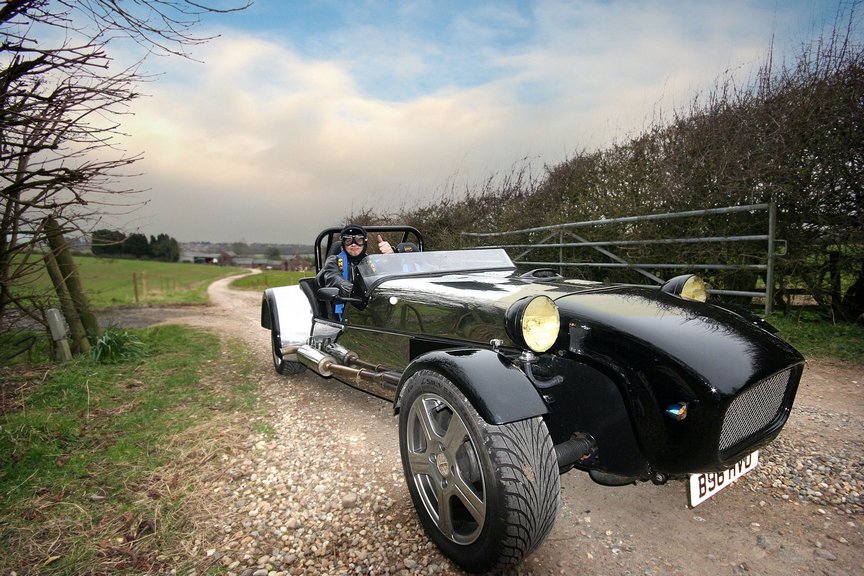

  25. Andi
    Aeroscreens
    Havn`t used a bike helmet yet, but i know that after maybe 1.5 hours motorway driving, or like in the picture.. 14 minutes in February. I would be happier with one. I personally think an aeroscreen adds excitement to the experience, though after a while I do get knackered. Originally I wanted to go for screens and side screens but now I wouldnt change it. This time of year (rain not included) Good sunglasses, and lightweight jacket under the seat is ample
