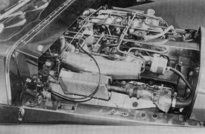

    hi andy, we need to know which model your s7 is to recommend a donor. i didn't see the ebay add but pictures would help. i have a sierra-based s7 and can copy the build manual if it turns out to appropriate. if its that model you need an early, pinto engined sierra, rear wheel drive, hatchback to build it using a single donor. you can of course put different engines etc in but you will need to modify associated mounts and bits for it. not sure when i can copy the book as i've just bust both wrists montain biking - hence the lower case one fingered typing - exclamation mark. picture of v12 from the book for interest,

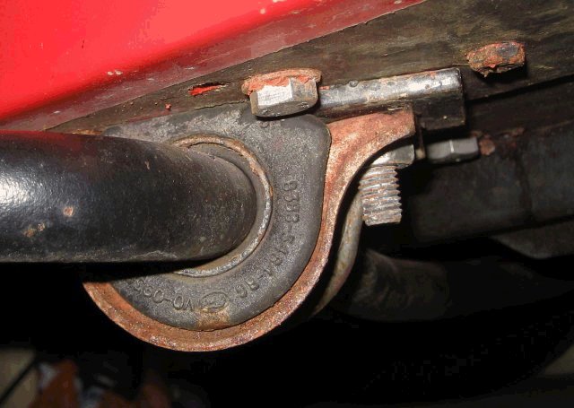

  5. Mine's a series II but similar I think as far as the anti-roll bar goes. I think he anti-roll bar would actually like to sit higher than underneath the engine bay but it's ok. The fitiing on the sierra is slightly dished so mounting the bush up against he floor tends to bend the floor panel. I put a mild steel spacer, chamfered off towards the bush, under each end of the bush bracket and a longer piece on top of the floor panel to provide some stiffness.

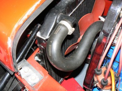

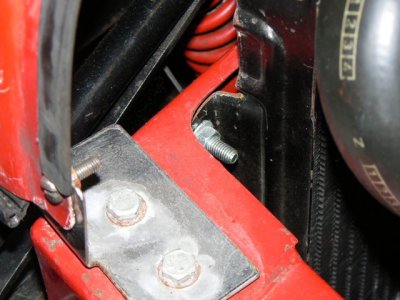

  11. Hi Karl, The advice used to be to cut some of the monocoque cross member away to allow more room. You can see here that I cut some away but left enough to leave a lip so that there is still a folded section for strength. Some builders I know did cut the whole thing away. I have enough room to fir the rad and the original viscous fan. This has been fine but last summer I did get overheating for the first time in the 10 years since I built it. This may be due to sludge as it stood unused for a couple of years so I may have to visit the coolman solution.

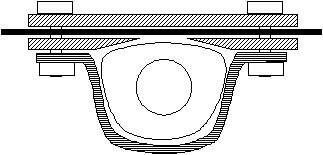

  22. As I remember, the ford bush expects to be fitted in a thicker bulkhead and perpendicular to the shaft - I made up a bracket as shown by the thick black line. The springy washerery thing goes down on top of the bush to prevent the inner bush bit migrating up the shaft.
