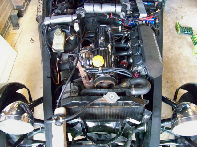

I sat down and went through all the paperwork thoroughly and noticed the log book says 1600cc, and i was sold it as a 2000cc. I was wondering whether there was an easy tell tale sign between the engines?
I've attached a picture of the engine...

2L 1.6L engine differences, external none that you can see from the picture.
Have a search on the pages here. I have a feeling the engine size is coded into the engine serial number as is the date of manufacture. I don't think there is a casting 2L or 1.6L on the side of the engine. The serial number is below the exhaust to the front on a machined ledge. The internals are different, head, valves, pistons and crank shaft. 1.6L engine code is LCS and 2L engine code is NET & NES.
Your car looks like a sliding Pillar 2B. Kit available around the early 2000's.

On the exhaust side of the block there should be cast-in numbers 20 or 205 if it is a 2 litre, 16 or 165 if a 1.6.

Under the exhaust manifold about in line with number should be a large 16, 2 or 205 so easy to see what you have.

There are also 2 types of 1.6 to my knowledge to make it more fun. A tall and a short for want of better words. My 1.6 is the eco version and is the same height block as the 2ltr with a longer stroke than the shorter 1.6.
Mine has 165 in huge numbers cast on the exhaust side.
Hopefully you have the 2ltr. if you don't and you want to replace it should be a straight swap. even easier with the tall 1.6 as everything should fit back in exactly the same place.
The '5' on the end i believe denotes the stronger later blocks eg. 165, 185, 205 as opposed to 16,18,20 blocks.

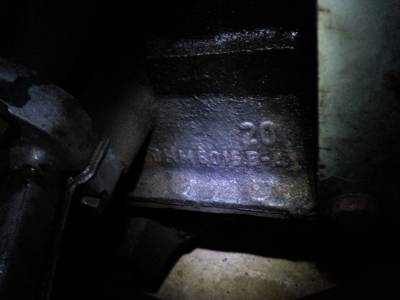

It's a 2.0ltr! Big old 20 stamped on the side. A little bit of rubbing down and cleaning is needed to make out the longer number underneath!
good news but you will have to update dvla asap or you will have insurance problems if you have an accident and the engine is wrong.
Yes, that picture shows the casting numbers. The engine number will be stamped into the raised rectangular pad directly above them. you'll probably need to get some emery on it to clean the paint off back to bare metal before you can read the number.
