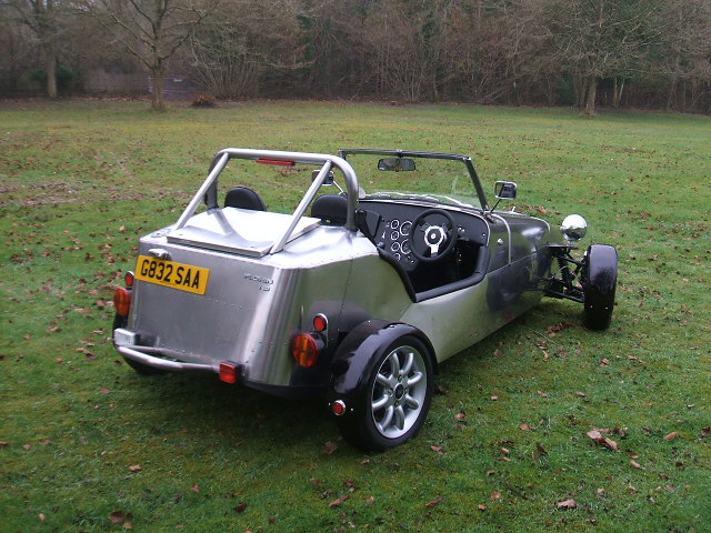

Hi. I'm putting rear wing on 2b, followed old videos exactly, I don't lik the large gap between wheel and wing. Does adjusting coil overs higher and lower car or just harden and soften suspension. Many thanks. Dave
It's not great is it, I had the same issue.
You could lower ride height but this will give too much camber, camber wedges can be fitted to reduce the problem but rear toe can then get too much. I found if the rear ride height is set to give about 1deg of camber them toe was about 0.5deg. When you lower the ride height the toe increases I think lowering an inch gave another degree of toe which I think is too much. I lowered the arches 1 tab at the back and 2 tabs at the front and remade the bends to suit. I also lowered the suspension an inch which looked spot on. However the car did bottom out so I put the suspension back up, the wheel arch move reduces the gap by 30mm and doesn't look too bad.

Adjusting the coilovers only adjusts the height.
To adjust suspension harder or softer, you need a combination of different springs and
adjustable shockers.
The 2B was "designed" to have a big wheel arch gap.
Its because we use the standard Sierra rear end.

Just because it was designed to have the gap doesn't mean you need to build it like that.
Put the wing where it looks best and fill the gap with some 0.7mm sheet steel for a much better look.

Hi thanks for you comments, I've already fixed them so if I lower them i will have the holes showing,I thought there might be an easy fix like winding down the dampers.cheers. Dave
Guest 2b cruising
I have found 7" just in front of rear wing measured from bottom of sill to ground makes a good free none grounding ride. This I adjusted on coil over.
The front measurement from sill to ground was set at 6". Just behind wishbone rear mounting bracket.

Hi thanks for your replies, I took advice from 2b cruising, worked out fine with measurements front and rear. Cheers. Dave
