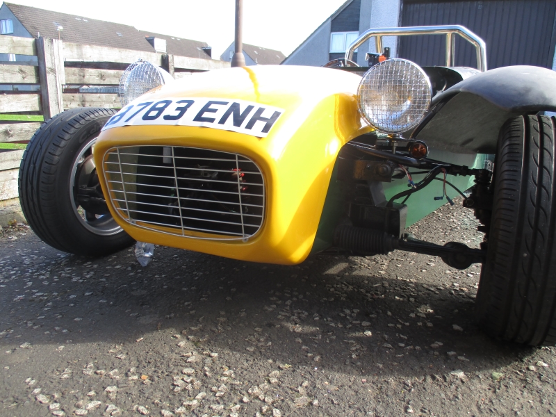

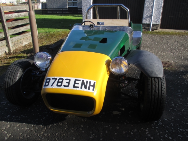

It will be near the front edge of the nosecone about an inch from
the edge. See attached pic.

Use some clear silicone. Will stick down the plate and can be removed at a later date without too much mess. use masking tape on the nose cone so when you wipe off any excess you get a nice seal between plate and nose cone with no mess :crazy:

The problem you're having is the vinyl won't conform to the complex curve of the nosecone, so I'm guessing airflow is getting under gaps and ripping it off?
