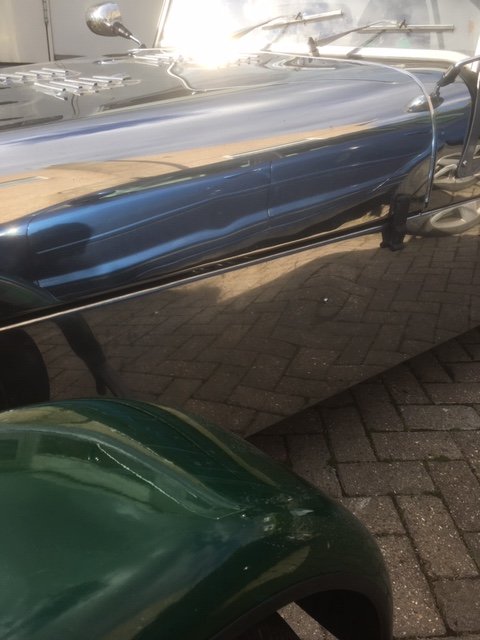

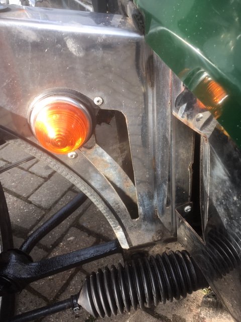

There is a gap between the bonnet and the sides of the car see pic 3, is this permissable?  Is there a seal or strip of rubber that should go there?

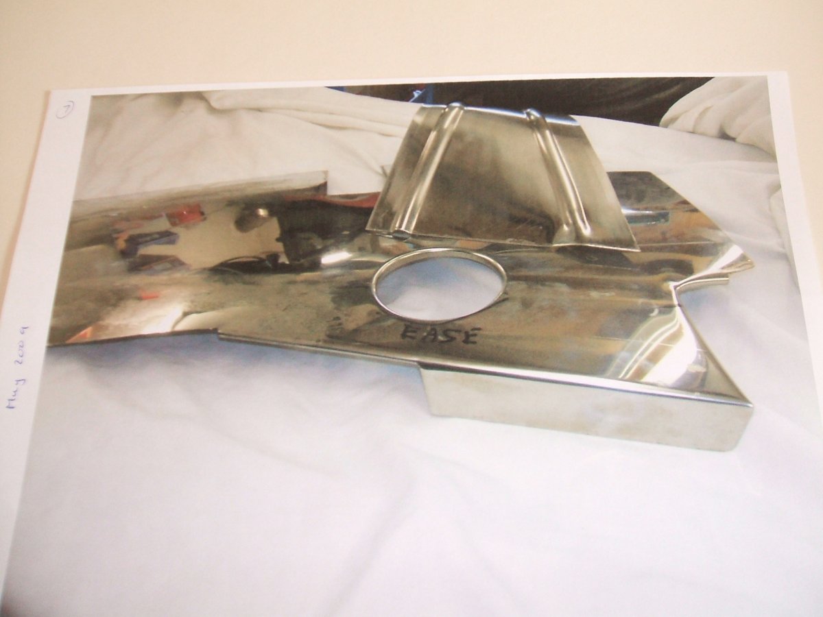

The internal sharp edge on the front susspension.  see pic 2 do they need rubber protection?

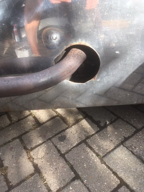

The round edge that is cut into the side pod for the exhaust.  See pic 1.  should that have rubber protection?

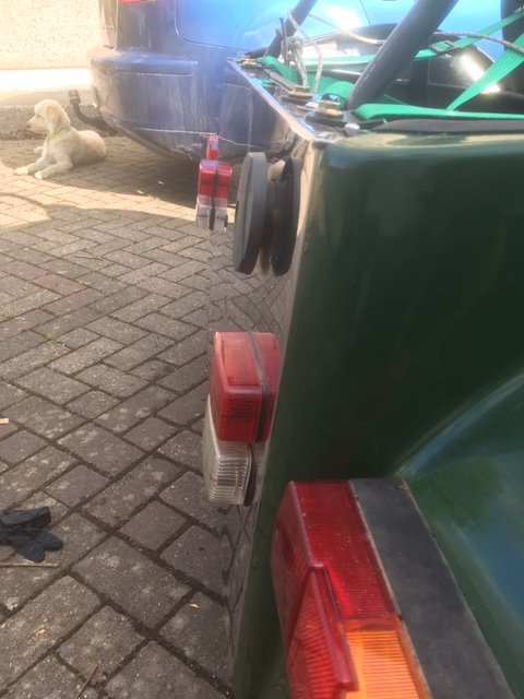

I have seen on someone elses forum that they failed on the rear reversing light lense was not being horizontal and that it needed shimming.  see pic 1.  shurely mine is vertical enough?

Any edges with a radius of less than 2.5mm need to be protected so protect round the exhaust, the front suspension is a bit of a grey area as they have an exclusion zone in this area but for the sake of it put rubber over edge - minimal cost and effort. The bonnet gap should not be a problem as the edges are radiused anyway and the IVA ball test should show no concerns.
I would be tempted to shim with rubber the reverse light as very little effort to ensure compliance.

Gap between bonnet and car sides - not an IVA fail so I'd leave it and maybe add a strip of foam post IVA to keep some of the dirt and water out.
Hole where the exhaust comes through - using the size of the exhaust for scale, it looks like the front edge of the hole furthest from the exhaust might be contactable. Put edge trim on it with the join at the back edge behind the exhaust where it's less visible.
Hole in the suspension buttress and the one in front of it  - again contactable so use edge trim. This stuff has glue in it so sticks well and will bent to a tighter rad than the other stuff you used. Take spare edge trim to the test, you might need it and £15 worth of it could potentially avoid a retest.

My tester failed mine on the space around the exhaust pipe which was less than yours and required a radius on the edges, this had to be metal as the heat from the exhaust would compromise rubber and because he wanted to see it as a permanent solution. His explanation also was that a pedestrian could catch their fingers in the opening, extreme chance but within reason what he said I had to agree with.

Make a "joggler" from a 6 x 25 mm piece of steel bar, hacksaw a 6 mm deep cut @ right angles about 10 mm from one end & use to turn raw edge into the engine bay. ( an action like an old fashioned tin opener ) all the way round; a little at a time. Repeat until raw edge is turned in.  May need to use a smaller section bar of leaving exhaust in place, or remove pipe to do the job properly.
Bent metal is far more permanent than trim!!!2010_0206KITCARRHOCAR0007.thumb.JPG.f217a28af32e6d387ea5278ec1918e30.JPG
My tester (Southampton) failed my rear fog-light on not being perfectly vertical.  But he passed my reversing lights being slightly angled.

My edges were glass fibre so I did a fix for the tester using 15mm copper tube bent round to suit, I needed something to transmit the heat quickly away as the exhaust can get rather hot from the turbo and Westfield bodywork is all resin plastic.

- I too was picked up on foglight not being perfectly vertical; made 3D printed spacer to address. Rule did NOT apply to reversing light. Clearly stated for the fog light in required standard "Fitted so that the reflector is facing squarely to the rear". Do not confuse with "angles of visibility" which is a different thing entirely. Reverse light has no such stipulation and just states "must be positioned to face rear". However, I still spaced my reverse light the same as the fog light, just because it would look odd otherwise!
- On the exhaust hold at the side of the car, I put re-enforced rubber edge trim around it and passed with it as such. I guess my examiner wasn't so strict in that sense. Rather ridiculous treatment by your examiner really - a pedestrian sticks their fingers in the gap *around a hot exhaust manifold* and the concern is they may cut themselves? My god, what if they put their fingers within the wheel spokes and sliced the end of their finger off against the brake caliper 😮 I best fill in my wheels!

Thanks for the info, I may have got mixed up with fog and reversing lights.  I knew I had seen something on someones blog.  I havent got a 3d printer though so it will have to be a strip of rubber.
If you can check me the dimensions of your fog light, if it's the same as mine (as supplied with Zero kit) I don't mind printing one off for you for the cost of the material and postage (<£4 I suspect)... PM me if you want... ;)
