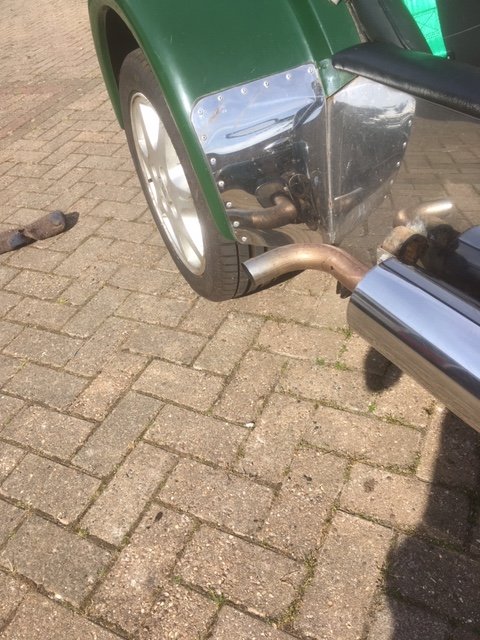

On the picture of the wiper, is thev plastic nut cover on the main bolt sufficient?
and the front edge of the silencer is slightly rounded, again is this sufficent?

Ok to the wiper nut, mine had a side bolt and I covered the same way - no problem.
I changed my silencer to a folded edge version to be sure. 2.5mm radius rule applies, but also the IVA ball end test tool.
Quick temporary fixes could be to apply some exhaust paste round the inner rim - I know pretty pathetic but will cover the rules if done neatly, or get some thin stainless and bend round the edge - will take a bit of skill and perseverance.

2 other options.
Make a heatshield to go round the silencer and put the edge trim on that.
Get some 6mm stainless steel bar. Bend it to a big ring and tack weld it to the ends of the silencer

A guy on the locostbuilders forum came up with a very inventive (and cheap) way of getting round the exhaust can edge issue for IVA. He chopped up an old stainless dog bowl and fitted it over the area. I bought it off him after IVA actually but have since lost it during a house move.
It was made to bolt on to the 2 holes on his motorbike can but you could make one that clamps on using a hose clamp or something:-

i used a heat shield to get mine through I’ve and the edge of the heat shield has some aluminium u trim on it.

another query.  My exhaust points out to the side with a sharp edge , (see Picture)  Is that acceptable for the IVA?

Seeing as you have a number of potential fails on your silencer, I'd suggest posting a wanted ad for an IVA compatible silencer. One with a rolled tailpipe end, no sharp edges and one that has previously passed the noise test.
People have all sorts of stuff kicking around in the garage and you might drop lucky.
I can't see it in the pics, but the exhaust pipe outlet should have rolled edges if it's contactable with the IVA test sphere.
This is just my opinion, but if you've got the standard silence from RHE back in the day, you'd honestly be better off to just ditch it now while it's easy and buy a proper, IVA-compliant silencer that will also be of much higher quality than the one you've got on there, which will most likely blow the wadding out of itself within 3 months (if there's any still in there!)... I can thumbs-up the silencers Techcraft Motorsport sell; popular in the 750 race series as noise-compliant but performant. No issues with mine other than the nuts on it need captivating/lockwiring to stop them rattling themselves loose.

Will post a wanted add now.  Just realised the picture of my exhause did not download, so her it is
