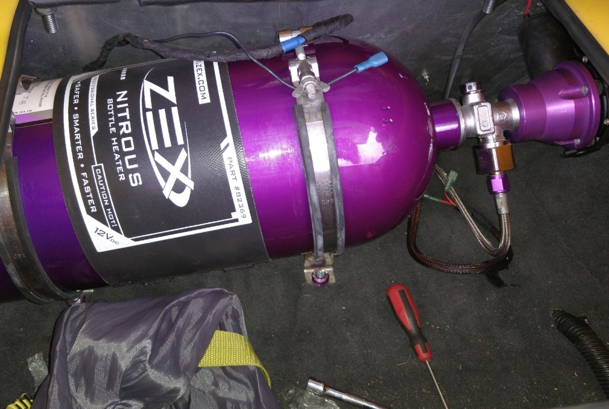

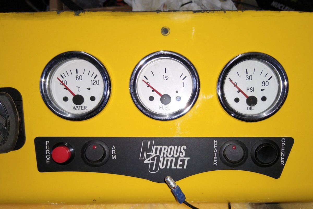

Hopefully my engine will survive if not, its only an afternoon to fit another. Starting off with 55hp jets because I do not have to retard the engine ignition or fit colder plugs, it is a fully managed Zex (yes Zex not Sex) system with single a fogger for fuel and nitrous. I have a bottle warmer, auto-bottle opener and just for fun a purge switch which I suspect will be used more than actually driving.

Photos so far, waiting for bottle pressure switch to prevent over heating.
