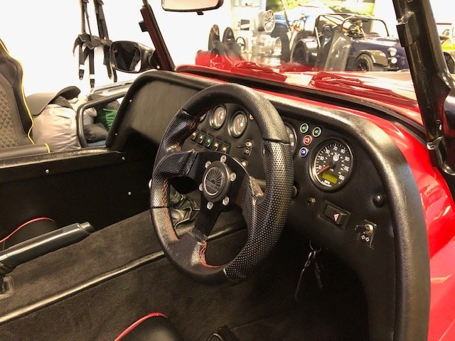

I have a Westfield SE FW on a 21 plate powered by a Zetec Blacktop 2ltr on Omex Throttlebodies.
The slight fly in my ointment is an intermittent fault which keeps blowing the Wiper fuse (10A).
