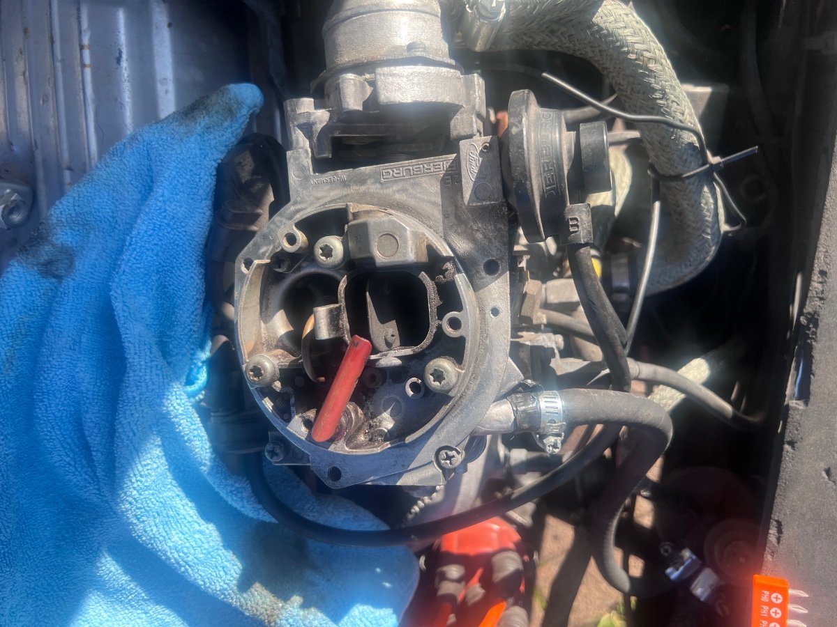

looking for some support on a filter for my hood that I’m restoring. I’m not sure which carb it is but looking for a pancake that I can fit either directly. I know over the year suppliers have gone but just looking to see if any supplier or website I can get to fit this carb.
current measurements are as followed. Hole to Hole on the our is 4inch.
inside diameter is approximately 90mm.
any support will be great

Sorry nelmo but of a noobie what’s an FI ?
what do you recommend something like a KN filter and re route?
Really want to avoid cutting into my 2B bonnet hence why I was thinking of a pancake as not much room
Pancake filters are pretty poor, you could look at pipercross px300 style.

The thing to remember about pancake filters is that on thin ones the restriction is the distance from the top of the carb to the top plate of the filter not the area of the foam filters.
Top plate on a filter like the one sparepart should be at least 1/3 carb inlet diameter above top lip of carb and idealy 1/2 diameter.
I agree, if the top plate is too low it could even block the carb. Years and years ago when I was a "boy racer" I took the filter off altogether and plonked a conical tube made from a yoghurt carton on the carb inlet, it made a great sucking noise on full throttle. just did not care about nasty thinks being drawn into the engine I guess. 🙂
