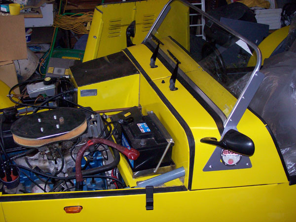

  11. and finally my scuttle area. The bulkhead was actually made from an old seat ibiza bonnet Ive made it a bit weird as the original rh bonnet piece just sits over a panel which holds the windscreen wipers and heater box. The wiper spindles just poke up through and are not actually bolted to the top panel so i didn't have to have bolt holes. The heater channels again just line up with the original holes in the rh bonnet. hope this helps

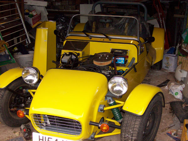

  12. heres my car from the front, with the bonnet section standing at the back of the picture

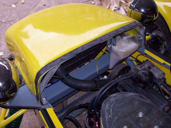

  15. Its nice to see other poeple are as crazy as me when i took a saw to my brand new bonnet and made it into a scuttle bonnet and nose cone . For the nose cone i made a former out of Aluminium flat which matched the bonnet shape. This was then bolted down to the chassis and the nose cose pulled down over it to give it the correct shape. My bonnet has a very little gap now on the corners where it meets the nose cone. A couple of alu "tags" on the bottom front bar secured the nose cone at the bottom. hope this helps. i can take pictures if required...
