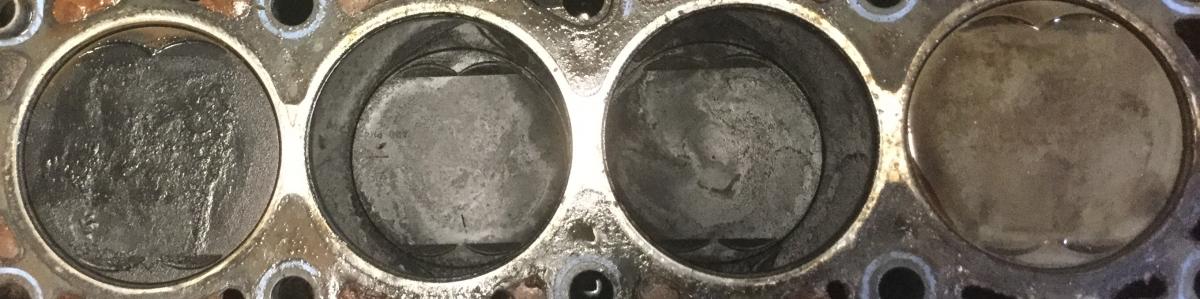

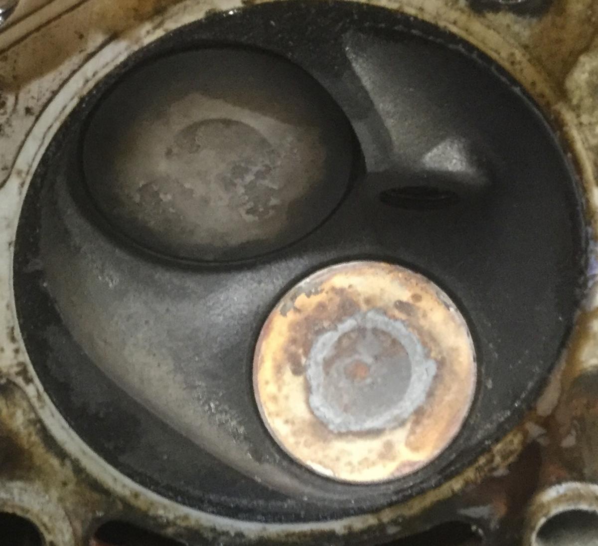

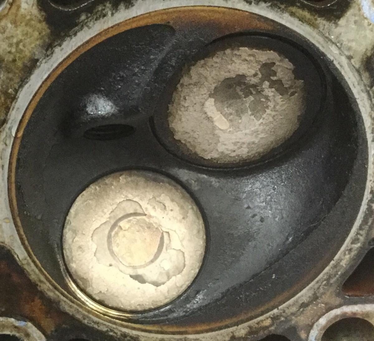

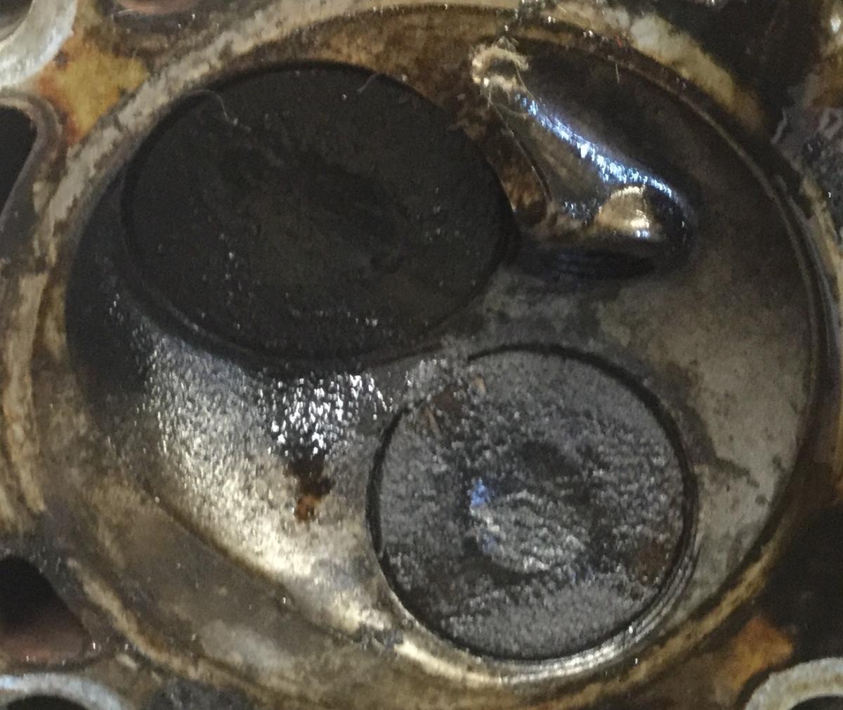

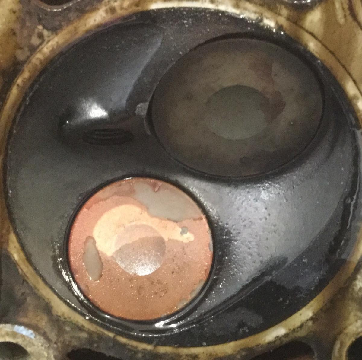

Hi all just an update I have taken the head off and this is what I have found.
post-13207-0-89250500-1495991008_thumb.jpgpost-13207-0-86785800-1495991026_thumb.jpgpost-13207-0-14731700-1495991038_thumb.jpgpost-13207-0-98779000-1495991160_thumb.jpg

Hang on a moment, don't go near the bottom end yet, the first and second photo show what looks to be oil coming through from the valve seat, this would point to the valve stem seals, go for the easy things first, stem seals and rebuild, see how it runs, if no change then easy to assume its bottom end.
To me it definitely looks like you have oil coming down through some of the stem seals into the valve
Have a look at the stem seals, check they all have the small springs around the top, generally they tend to go crispy and crack

I agree with the above. Valve stem seals first. If you want to have peace of mind then spin the crank so all pistons are at same level ish, chuck in a small amount of diesel into all bores and leave to soak in. Any that drop different to the others may need a look at.
Actually your heads dont look bad apart from first picture. Perhaps yours can be saved with a little refurb in the right places.
Sort out head then id look at rings if i were you.
I'm intrigued with the valve reliefs on the piston tops. They look like they are designed for a 16 valve engine. What engine is it?
