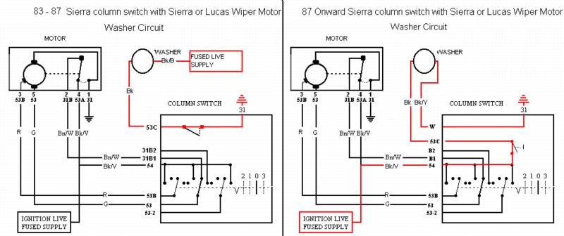

If it helps, here are my notes on how the wiring works with a mini wiper, the Sierra column stalk and the Sierra wiper relay... but let me explain a little on a few things.
- Ignore all the "X" reference numbers, these are for my custom loom that I made myself, so these are only references I understand what they mean :) they are for a Wurth TRM.
- The box at the top represents the column stalk switch, and the links show how the terminals are connected with the stalk in the relevant position (0= normal resting position)
- The box at the bottom right is the relay, I've put two versions of pin references on there as different Sierra ages had different pin numbering convention

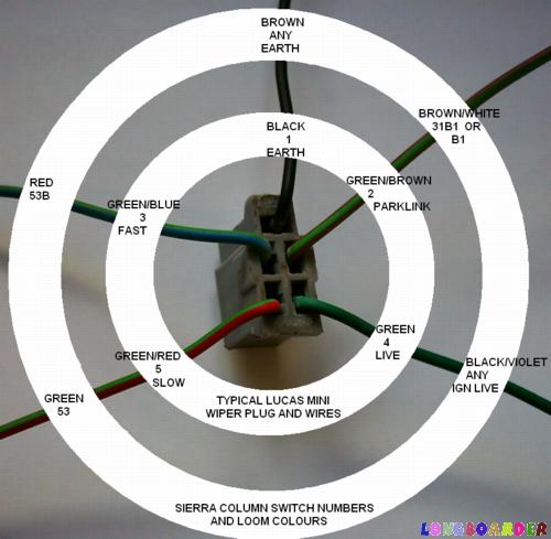

Ford were fairly consistent with their wiper terminal numbers. Below pic is sierra, same vintage as your escort stalks, and gives a fair starting point. If you have an old fashioned mini wiper motor with the self park box with five terminals, still on it. If there are just three wires sticking out of the motor you have lost the box.
Note terminal 4 needs a live supply. Trad ignition live but could be fused constant live and the wipers will complete a park cycle even if you switch off ignition.

Check the fuse box I cant use the button on the end of the stalk as it blows the fuse I dont know why But I now use the aluminium stalks from gbs so dont have washers anymore and they work fine
This is because you have a mix of stalks and wiring loom. You (or someone) has almost certainly removed phase 1 stalks and plugged phase 2 stalks into the old loom. The pin-outs are NOT the same; you need to do a bit of re-wiring for it to work.
Early sierras up to 1987 used a fused supply direct to the washer motor and the column switch operated on the earth return through the switch terminal 53C.
After 87 the column switch supplied a switched live terminal 53C again to the washer motor which then returned through an unswitched earth W on the column switch. Combine this with the VG loom and you get a short direct to earth which blows fuses for the washer.
Even later RH/RHE/GBS (whichever) tried altering the polarity on the switches but I think that was just for lights.
