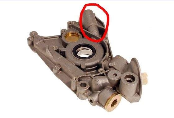

Not sure that is true of the Rover T16.  The relief valve is inside the oil pump and to access it you need to remove the timing belt and tensioner and then remove the oil pump itself.    Not my idea of 'easy' 😀
And that would not explain the high idle pressure would it ?   I can't actually find anywhere what the relief valve is rated at, although 80psi sticks in my mind from somewhere.
I thought the prv was fitted externally to the front cover. The pump is inside the cover concentric to the crank.

Edited by richyb66
Picture added
