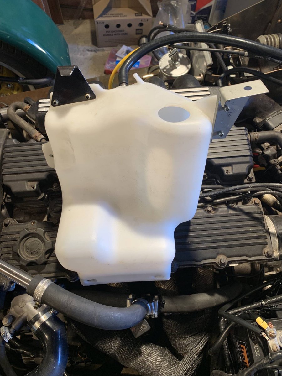

The end is near, well as I was hoping so then the next little conundrum appeared. Where to put the windscreen washer bottle. I have no space in the engine bay. Please help.
I fixed mine to the chassis tube on the right of the engine bay above the steering shaft on my Superspec. My bottle was a nice compact rectangular shape, not as large as yours though.
Mine is on the bulkhead between the battery and the peddle box. It's much smaller than yours though. It holds about 1 litre. Can't remember filling it up more than once in the last 16 years actually.

Thanks for your responses, I guess I’m on the lookout for a small (1 liter) bottle
If you don’t expect to be driving in the rain constantly then you done need such a large washer bottle. Car builder solutions and other vendors do various style of bottles and bags that will suffice.
My superspec has a bag with a pump in it And it's fitted underneath the battery tray or around that area, the tray has a little hole cut out so you can fill it.

I needed the space in my engine bay to reroute some hose and fit a header tank so I moved mine in to the passenger compartment and fixed it up almost out of sight. It's a bit more awkward to fill but I hardly ever need to anyway and it's not in the passengers way. More space in the engine bay is never a bad thing.
Ditto AndyW - small rectangular bottle above steering shaft.  I think my came from Car Builders, but you might find the same on ebay or google.
