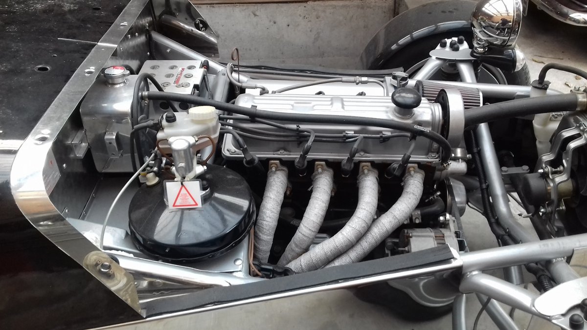

Welcome to the club, I have a 2B and have a 4-core mini radiator, having an expansion tank piped from the stat housing and an overflow bottle from the rad pipe see the picture.
