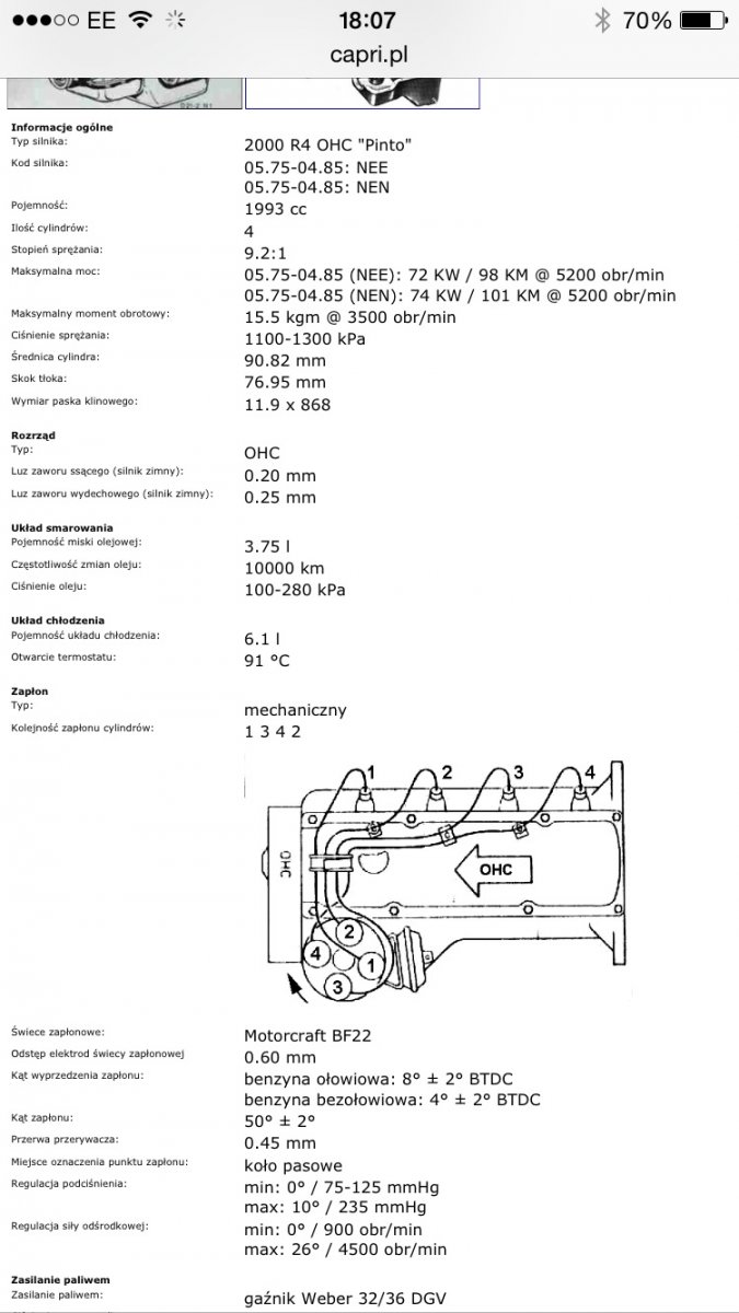

It's not running right I thought it was a carb but set that back to base level screw all the way in then back out 2 turns, but even with that it's still banging & popping, refusing to rev up. So I thought I'd check the timing, read it ought to be around 8 degrees, when I checked it assuming I did i right it's had 40 degrees of advance, I'm managed to pull it back to 32 degrees but now the wiring is hitting the engine. Looks like I'll have to swap the leads back a hole & try it again tomorrow, but can you just sensecheck my logic.

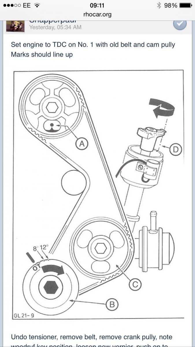

Engine turns clockwise, there are markings on the crank pulley, they appear to be the first mark 12, 10, 8, 6, 4, 2 & the last TDC with 12 being the first as the engine spins, there is also a mark on the casing, I put some ink on the last mark which I believe is TDC & started the engine, my timing light is one with a dial on the back so you turn the knob until the marks line up with TDC then read the gauge.
The quality of the image isn't great but can somebody confirm that the engine is now at TDC

Assuming it’s the standard cam pulley it will have a pointer at the back which lines up with a mark on the head when the crank is at tdc . It will only line up every second turn of the crank as they are geared 2:1
Check the valve timing by all means but far more likely is the pulley which drives the distributor has not been correctly timed when the belt has been refitted hence the distributor requiring turning further than its usual position to achieve ignition timing.
with the engine at TDC the pointer on the cam pulley should point to the mark on the head and the rotor arm should point to number one spark plug lead on the dizzy cap and also number one plug lead should be closest to cambelt the timing marks on the pulley are TDC then 12 10 8 i would set it at 10

Right still fighting, pulled off the camcover & at TDC I have the cam in the right place, the dizzy is however 180 degrees out if it should be pointing to the front of the car & be closest to the cambelt. Either way to stop it catching on the block I turned it 90 degrees & then moved the leads to suit. It runs a lot better, I think it's at 10 degrees but my timing light went on the blink, it's one with a dial at the back to dial in degrees & it seems to have stopped working. But the engine runs a lot smoother, but I still have overfueling problems, plugs come out full of soot, trying to accelerate has flames coming out of the carb.

No 1 on the dizzy of looking over it from the passenger side points backwards towards the passenger footwell.
Usually you can set the tdc and cam then just withdraw the dizzy and refit in correct orientation. You still need to time it correctly afterwards but you should be close and have room to adjust.
