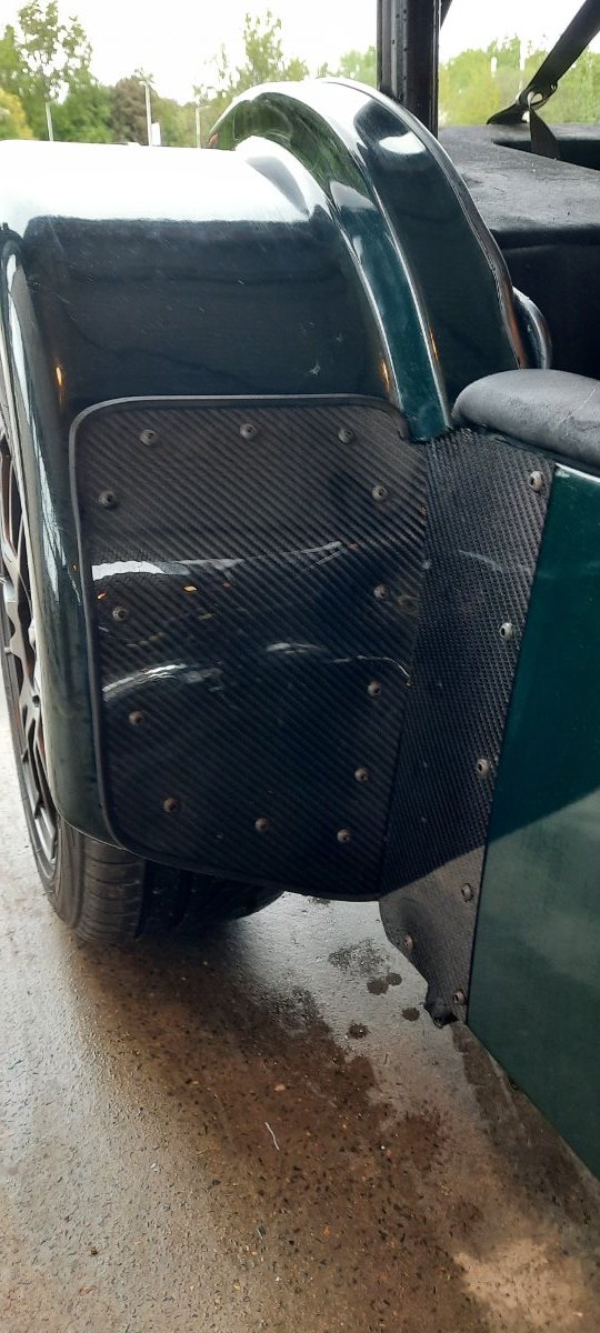

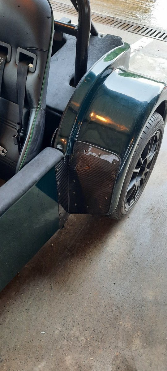

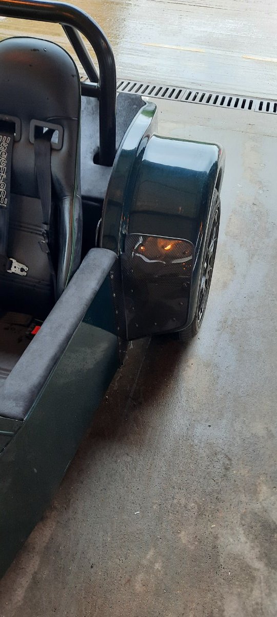

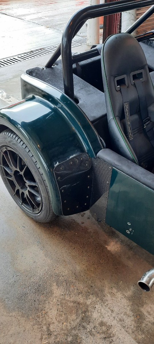

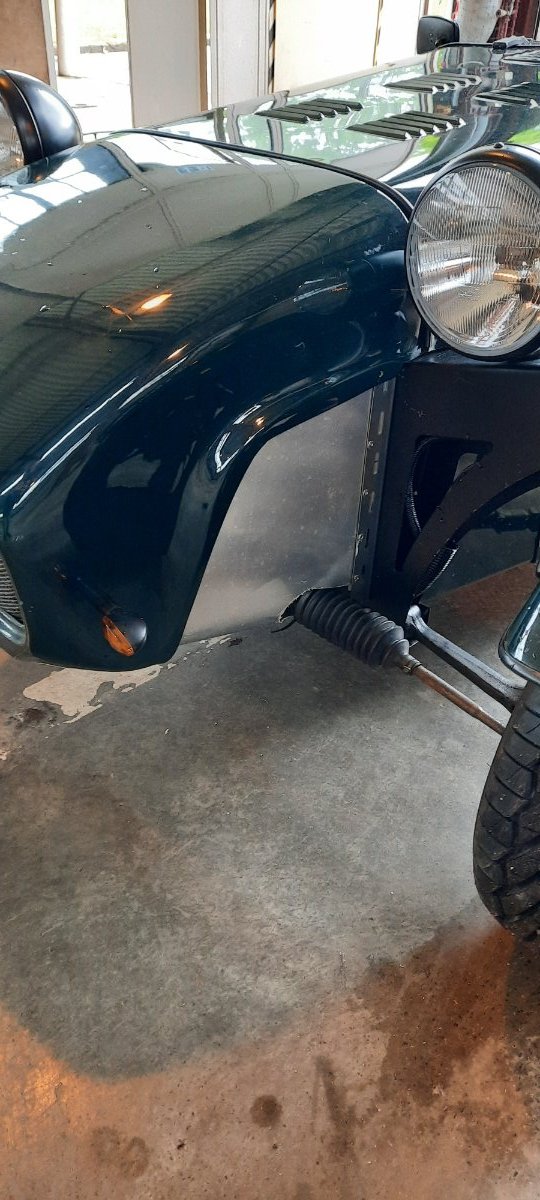

So after trying to fit the rear wings back I found that no matter how I tried, I couldn't get them to sit flush and so decided to bite the bullet and trim them back as they should be, as per the video from sparepart. Pics below of how they turned out, I bought some 1mm carbon fibre sheet and also used that to cover the old holes on the side.

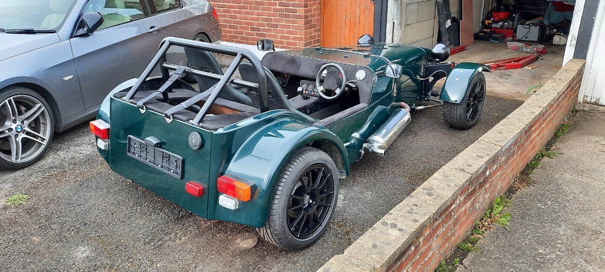

I also replaced the exhaust as the old RH silencer had sharp edges and was v loud.
Well done with the rear wheel arches, it was a big bullet to bite. From where did you source the silencer ? how does it sound ? it looks like it can be repacked ? Also what a cliffhanger of a statement "....or so I thought"   .... when is the next installment? ... on the edge of seat.

Sorry, I had intended to write up the IVA details when I got home but I was so knackered, had a beer and conked out!
The silencer is from a company called Blue Flame Exhausts. It sounds great, has a rolled end and no sharp edges. Good company to deal with, would recommend.
