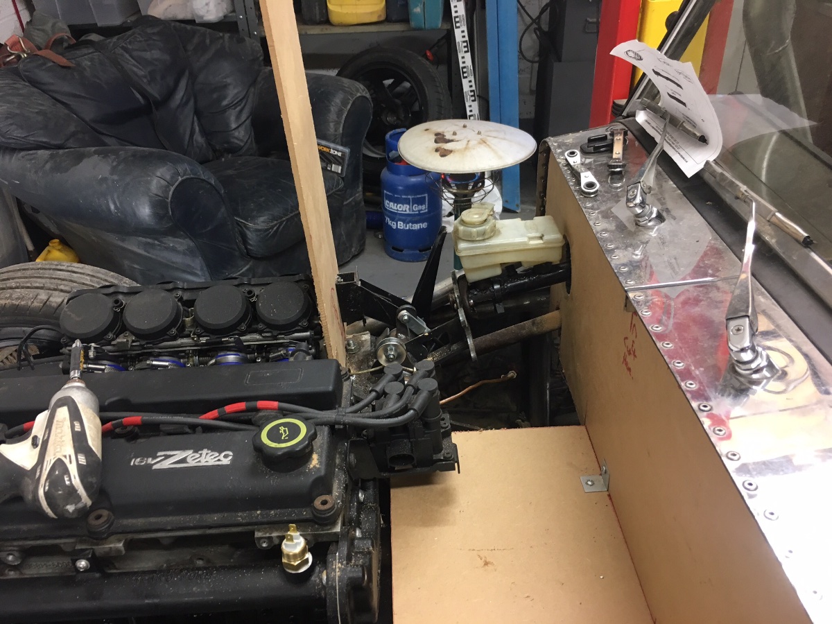

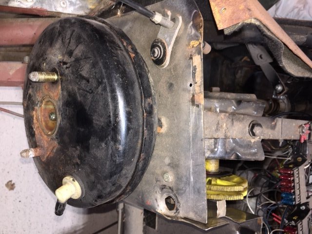

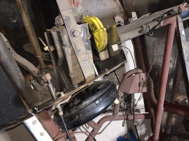

Dean - thanks for the edit earlier - it had me a bit confused before! Here's my pedal box set-up (such as it is!):

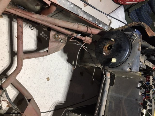

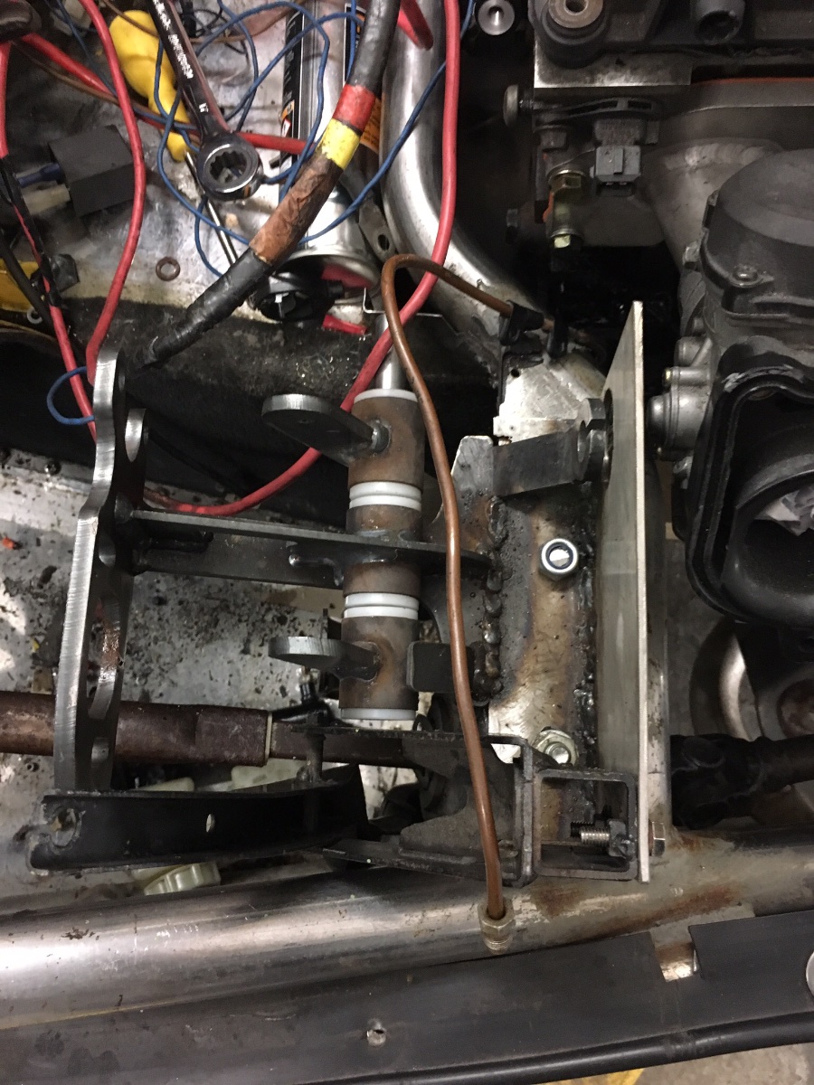

Ok so the servo won’t work there I got rid of it I don’t know if others have managed to make it work I ordered a pedal box from gbs and welded it in
Thanks again Dean - sounds like I'll need a new pedal box if we're going to drop the ST170 in. I presume we'll need a new master brake cylinder that sits over the pedal box?
I would be grateful to hear from anyone who has managed to install an ST170 with the original EFI set up.
Cheers,

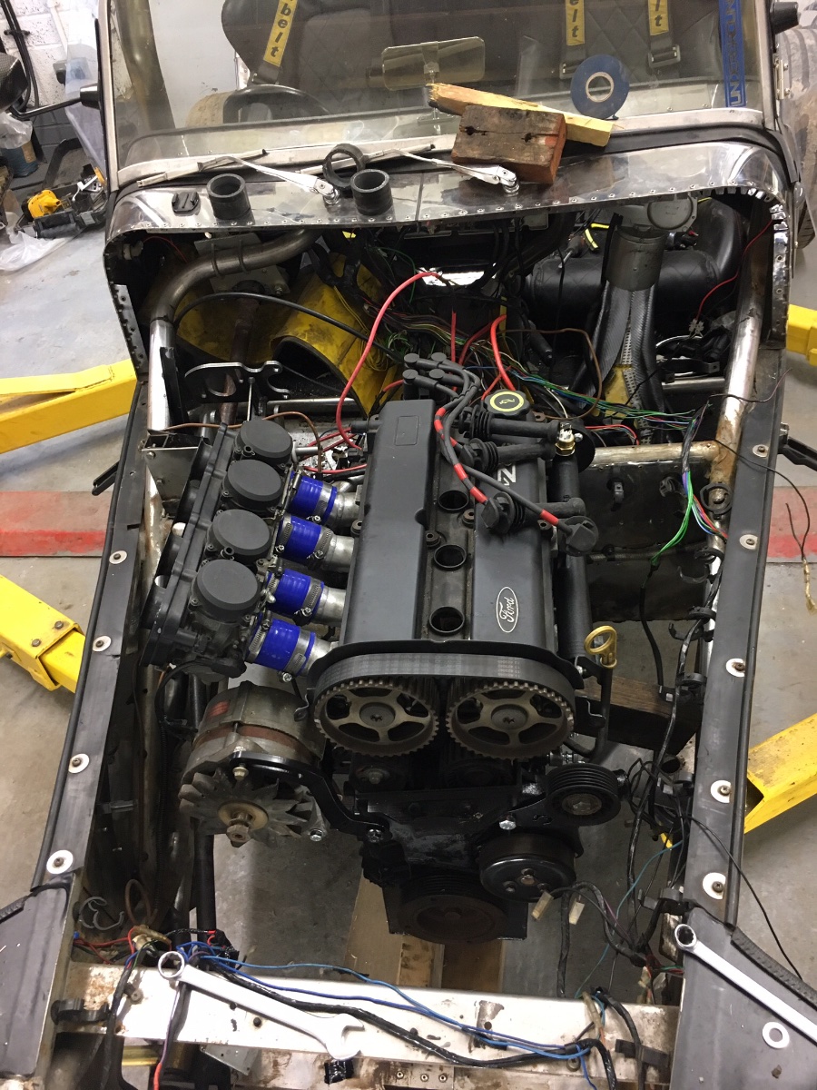

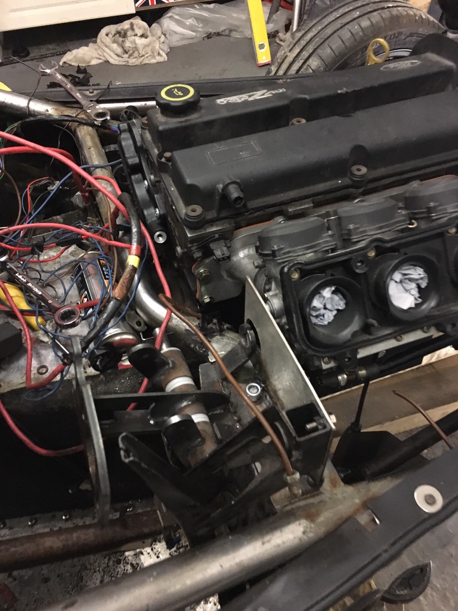

I used the original master cylinder I’ll get some photos when I’m over at my car next or check out red seven automotive engineering on Facebook my cars on there it may have some useful pics
I went from a Ford crossflow to ST 170 in a GBS Zero but kept weñt down the twin 45s route because they sound awesome and it was easier/cheaper at the time.

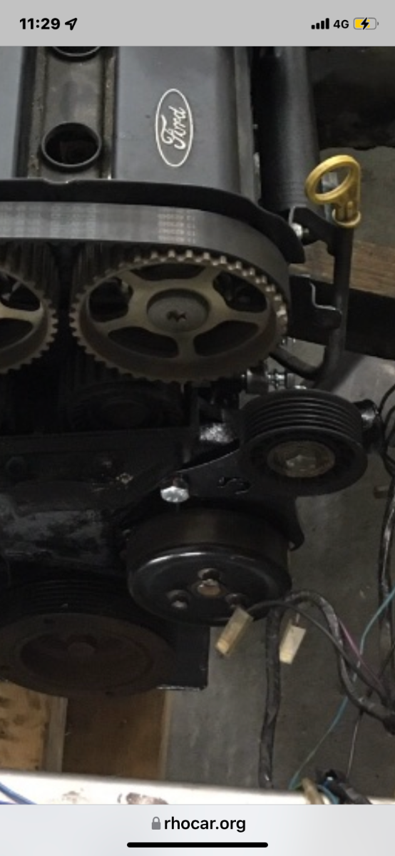

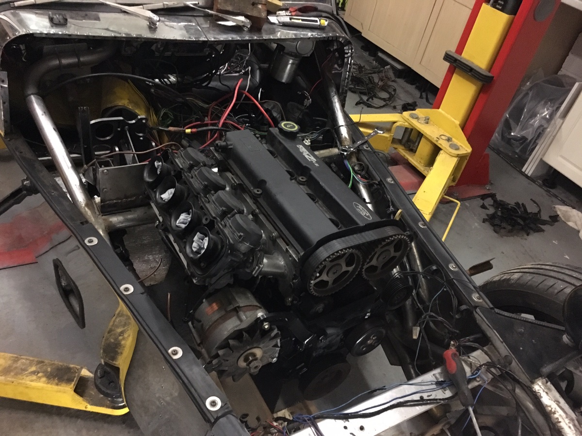

I know this is a old post…. Just looking through for some tips with my conversion, in the picture here I’ve added in off deans post, there’s a pulley above the water pump isn’t that to direct the pump in the right direction, where could I get that from
