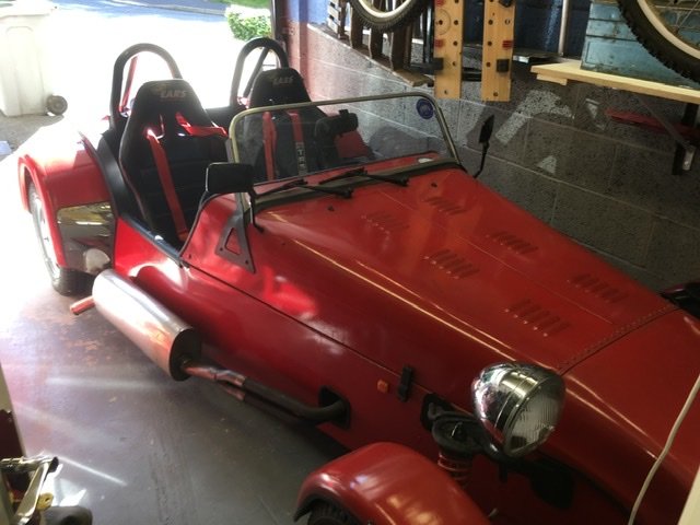

  2. I have to sell my 2B4, it has sat doing nothing for way too long wanting nothing more than a defect with the high beam lights fixing to get it to a point where I would take it for an MOT. I’m just at the point where I cannot create the time to fix it, and it’ll sit in the garage for another year waiting for me to get round to it if I do nothing. The car is a Robin Hood 2B4 with Cobra hoops, it passed the IVA test and is on an age related plate. It is pretty basic, as per Robin Hoods original idea, but has the following: 2 litre Pinto, with brand new starter, DGV carb and camshaft. New battery. Sierra pepperpot alloys with new tyres. GBS 6 gallon tank. EARS bucket seats with TRS harnesses. There are many “jobs” I also never got round to, e.g. new alternator bracket, alloy radiator, make the drivers seat adjustable (It’ll be tight if you’re over 5’9”) etc. I have £2,500 in mind for it, if your interested in more Info, please drop me a line. Cheers Nigel

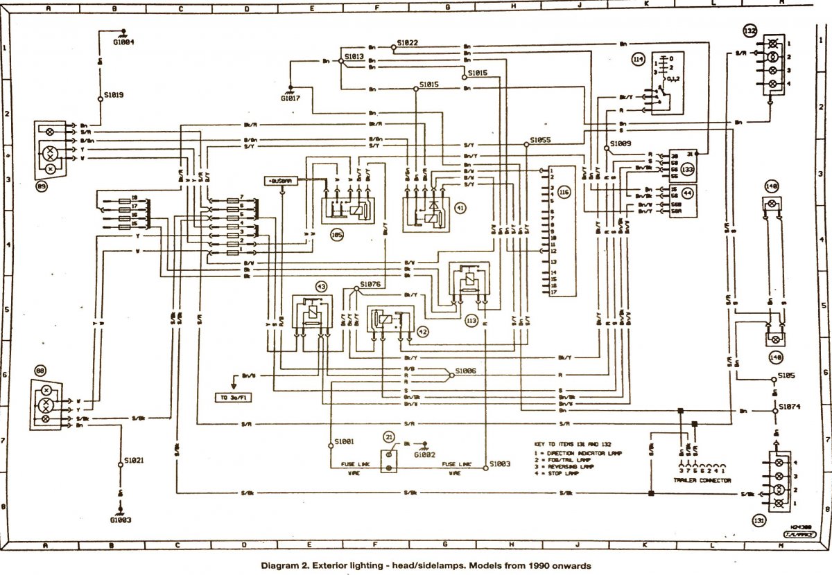

  5. Hi All, Trying to get my car ready for an MOT and it’s developed an issue with the headlights, probably because its been stood for years. All the lights work as they should when operating them with the ignition at position 2. When the car is running, all the lights work as they should apart from the headlights stay on when they’re switched off. If I flick the high beam on an off, the headlights switch off. I’ve attached my car’s wiring diagram, does anyone have a diagram/picture showing which relay is which in a standard sierra fuse box? I suspect a dim/dip relay and want to start with 42 on the diagram.. Many Thanks Nigel

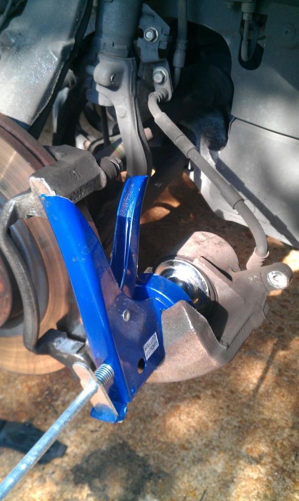

  13. I have 4 x 14" inch steel wheels from my donor car available to anyone who wants them and can collect them from Macclesfield area before the 31st October after which I will be putting them on th tip. 3 of the tyres (185 65 14) are OK, 2 x 4.5mm & 1 x 6.0mm, the other one is legal! PM me if you want them. Cheers Nige
  14. Just seen this idea for a brake spreader and thought I'd share it
