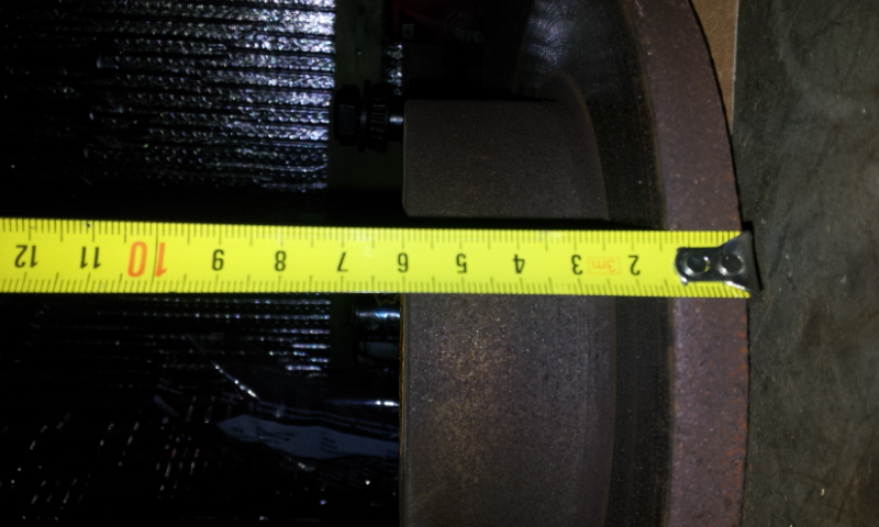

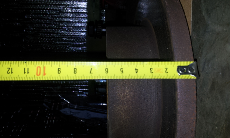

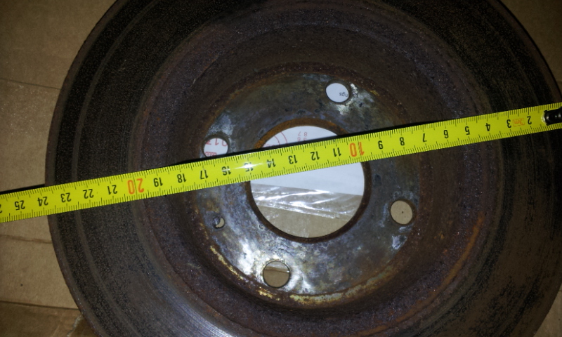

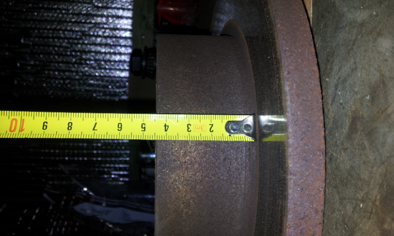

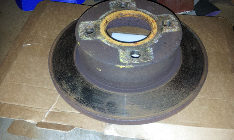

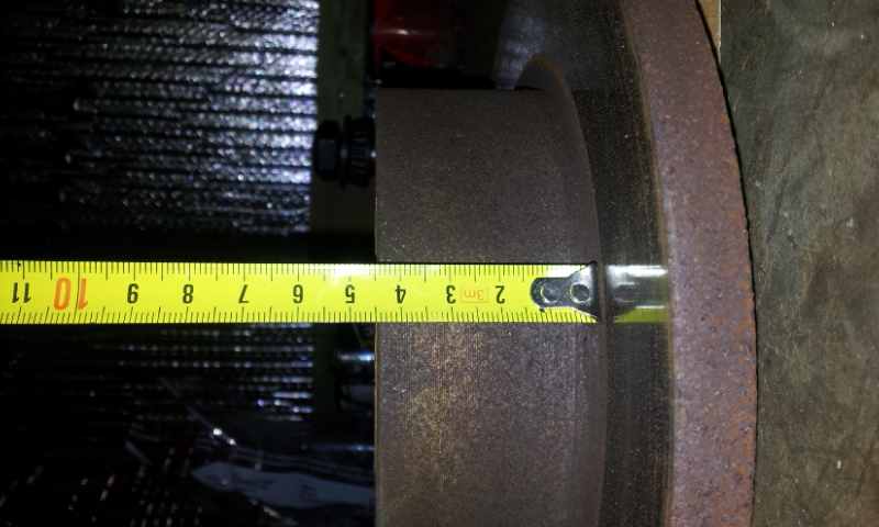

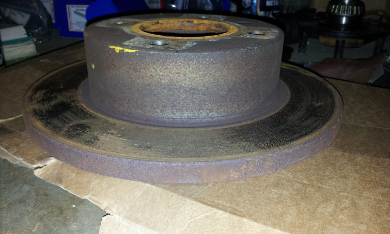

  5. Found out what the discs are off, a mk1 Sierra 1.3, solid ones, so I got some off eBay £14 for a pair, old stock but brand new, they never made vented in the dimensions i needed, thanks for your help Cheers Ivan

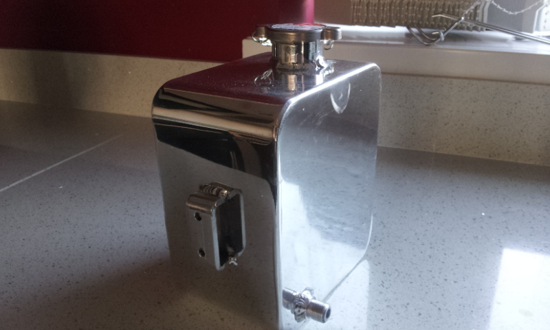

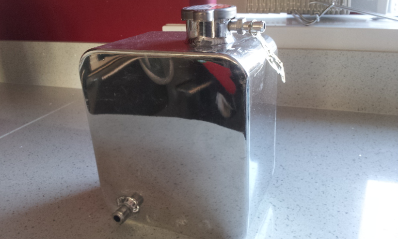

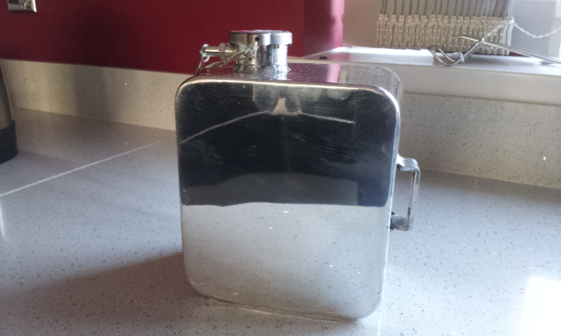

    try this 1, just got myself 1, off ebay 2 Litre Aluminium Alloy Coolant Header Water Radiator Tan... (380829780665

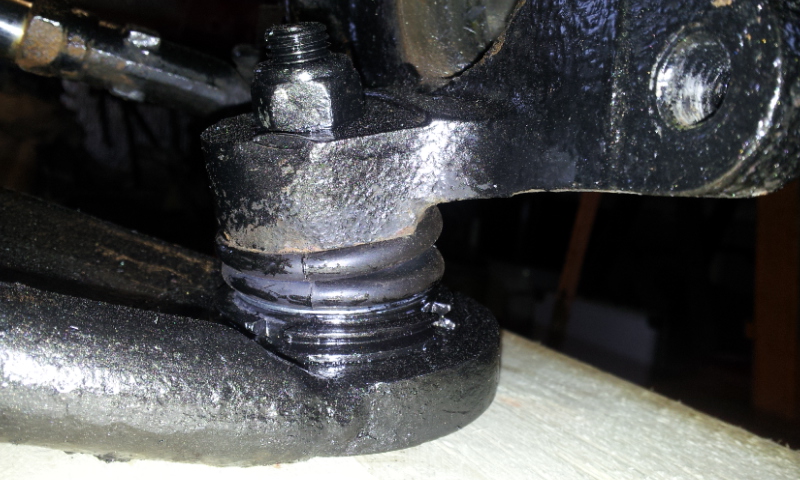

    on mine the base of the ball joint is threaded and mates up with the threaded female section on the end of the wishbone ,see previous pic, It may well be different to yours

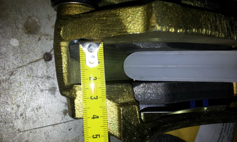

  10. and some more pics, 2nd pic is my new caliper
  11. more pics, my old disc, want new vented to replace these
  12. hi all, could anyone tell me what vehicle my front discs might be off, in the process of changing my discs and calipers, thought that they were all sierra parts, how wrong was I, calipers are from a mk 6 escort, discs I don't know, the ones I've tried are not deep enough so don't fit on the hub correctly, see pics, I'm wanting to put vented discs on, got solids at the moment, can anyone help!!!!!!
