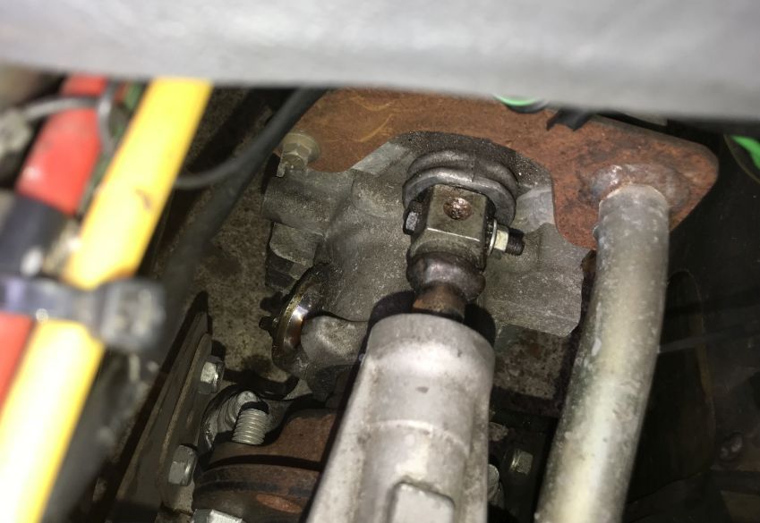

  7. It's a bit fiddly but you can easily remove the remote gear shift mechanism to have a look at the alignment. (I took mine off to get at the UJ underneath). The whole shift mechanism is only held on with 2 bolts through a C shaped plate into the end of the gearbox, plus the clamp bolt onto the gear selector shaft. One bolt is underneath the locating tube on the right, which is really the only thing that holds the gearlever to the gearbox. The bolts are a bit of a pain to get at. With the mechanism removed you can straighten it or check the alignment.

  11. The UJ grease nipples on the Superspec are particularly awkward! The rear one at the diff can be reached ok from underneath with the car up on stands, but the front UJ is hidden by the gearbox mounting. Only way I could get to mine was by removing the tunnel cover and unbolting the gear-lever mechanism from the gearbox. Then youve got access down to the UJ. Even then I found I couldnt get my standard grease gun nozzle between the UJ yokes onto the nipple in the centre. I had to buy a smaller nozzle and even grind flats on the side of it so it would go in far enough!

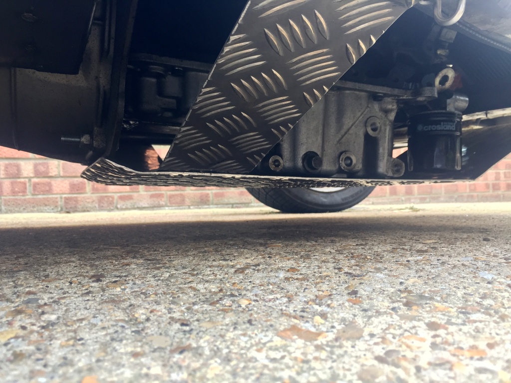

  18. Graeme, Yes the support wings at the rear of the guard are fixed on each side to the lower side chassis tubes using large hex head self-tap screws (2 each side). I was a bit worried they would break or work loose when the sump guard took an impact, but they seem to be holding so far. The front of the guard extends under the oil filter then bends upwards to the nearest suspension square tube cross-member, where it is bolted on with 2 rubber bobbins to give it some flexibility. The rear of the guard isn't fixed but just has a bend upwards to protect the bellhousing / engine joining plate. So effectively the guard is fixed to the chassis and the engine is able to move over the top of it. That's different to some other people's sump guards where they have fixed the guard to bolt holes on the sump / block itself. Also there's about a 3mm gap between my sump guard and the bottom of the sump with some neoprene strips stuck on to stop stones getting between and also dampen any resonance.
  19. The alloy sumps are about 7mm thick so luckily they will survive a bit of abrasion. Mines actually got a hairline crack in it but it doesn't seem to leak so I'm leaving it alone. Oil filters though are only thin steel and vulnerable as you've found out, so it's worth fitting a short one. I'm using a Crosland L10288PS filter (Eurocarparts p/n 501750018)
  20. Mines the alloy sump, about 12cm deep. I think the steel sumps are deeper. Which has now confused me!! From previous digging around I understood that alloy sumps were fitted to Rover 420 and 620, and steel sumps to 220 and 820. My engine number indicates it was for an 820 but its got an alloy sump, which doesnt tie?! Maybe my original builder changed the sump. Btw the alloy sumps have larger bolts and are thicker, as some had engine mounts fitted to them.
  21. Graeme, I'm plagued with cushion type speed humps where I live. The sump clearance on my Superspec is only about 5cm so I was finding the humps too high to straddle and I was forever rubbing over them. Once I even got beached on top and had to get out the car to push it over! I now find the best way is to run one wheel over a hump and put the other in the gap between. That's when I remember! To protect my alloy sump I've fitted a shorter oil filter which doesn't go lower than the sump, and also built a sump guard out of alloy treadplate. It's more sacrificial than resistant but 2 years on it seems to be providing good protection. I'm now not so worried about grounding the bottom of the car.
