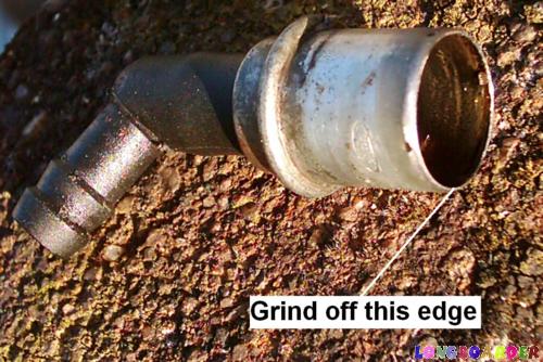

    Some people have had crankcase pressurising in the past because the Ford produced elbow that fits into the block breather has a one way valve in it. This valve does require slight intake vacuum to open and ford plumbed it into the inlet manifold. This ensured negative pressure to open and evacuate the crankcase and burned the oil fumes by passing them through the engine. All good till kitcar builders put the pipe into a catch can or vented it below the car. Without inlet vacuum to open the valve pressure builds. So remove the valve from the elbow or better still feed it into the inlet manifold. Below is the breather valve. The lower edge has been ground off and the lightly sprung 'penny valve' plate has dropped out.

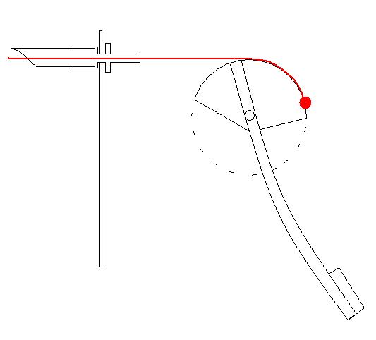

  7. A more elegant solution to avoid fatigue failure and significant flexing is to make a simple quadrant based on a grooved circle of the same radius as the height of the adjuster above the pivot of the axle round which the cable runs and is fixed. Basically just what Ford did with the sierra pedal, minus the adjuster.

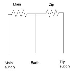

  13. So you have confirmed the headlights are wired correctly and the loom is not faulty. There is no link from dip circuit to main beam warning light when the bulbs are removed from the circuit. I can only think that the backfeed is via the bulbs. Presumably you currently take feed to the warning light from the main beam wire after the relay. Are you using later BG87******** column switch and negative switching of relay. Can you rewire the warning light to be switched by the column to relay switching wire, rather than the post relay wire?
  14. The main and dip circuits should be completely separate at the stalk end. Common problem that links the circuits is incorrect connections at the headlight end to the bulbs. So first step is to pull the connectors off both headlight bulbs and then switch on dip and main and see if you still get a glow from the main beam dash light. No glow? Then the switching is probably OK and the problem is probably the bulb plug wiring. Try connecting one head light and test. No glow. Disconnect that headlight and connect the other side and test. This could tell you which headlight has its wires swapped. Could be both. The main/dip bulb is set up like the pic. Regardless of how you swap the wires round it will seem to work OK (till you drive at night!). However the central connection between the filaments is the earth and connects to the shell of the bulb base. The dip and main wires then each connect to their proper bulb centre contacts, which will then work independently, one filament at a time and not feed back to the warning light.

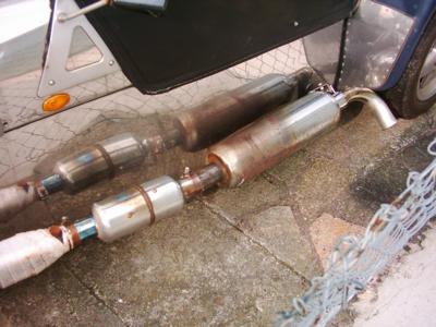

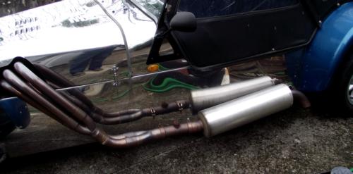

    Exhaust Noise
    Putting in a small expansion box had a huge effect on mine many years ago. The one shown was an old silencer, gutted and shortened to about 10" long to fit. Have since fitted a 21" x 6" which is OK but not as quiet as the expansion box + small silencer and looks huge and ugly.

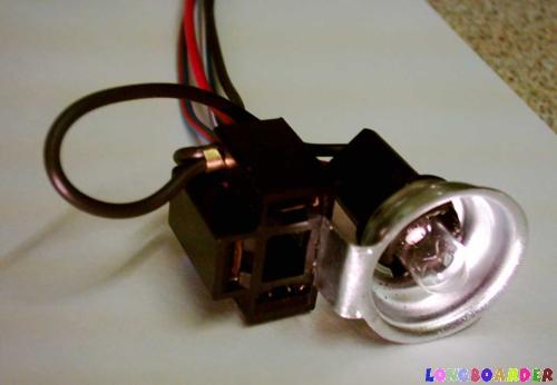

  18. Side/outline/running/marker lamps have been obligatory since the start of SVA/IVA. I'm surprised the car passed IVA without and surprised it's only an advisory and not a fail. Put some on. You can get headlamp plugs that have a side light holder built in. Most headlamp reflectors have a hole in the silvering for them to shine through.

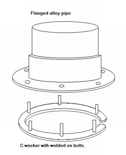

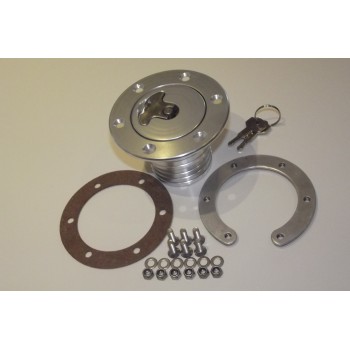

  24. To seal the tank well I made up a C ring (pic below) in 4mm steel plate with bolts welded through it to match the sender/tank holes. This can be inserted inside the tank and will pull up to sandwich the thin tank top and gasket between itself and the sender. Getting the cut-out in the C big enough to allow it to be fiddled into the tank but small enough to not loose sealing was the only difficult part. Pic below is rough idea that I used with the filler. Same style for the sender.
